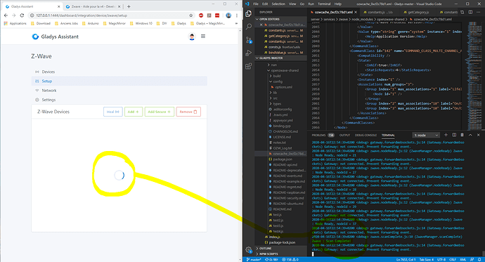

Bug:
When you click on the « Setup Â» page and the key scan is not complete, a loading button appears. However, once the scan is complete, it does not change state; you need to refresh the page or switch tabs to see the information update in the « Setup Â» section.

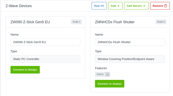

I invested in Z-Wave to control a motorized shutter
My key is well recognized by Gladys.
The module I used is a Qubino ZMNHCD1.
I just integrated the node into Gladys, the problem is that I can only lower my shutter (fortunately I kept the physical buttons :smile:)
There must be something missing because it’s a bit more than an on/off switch
Pierre-Gilles is already aware of my problem, but since there is a special Zwave topic, I take advantage of it to centralize.
I bought two Qubino ZMNHJD1 modules to control my radiators. I managed to add them to Gladys, but like VonOx, I only have the possibility to make a switch on/off, whereas normally I should be able to send 6 different instructions.
Same issue with my Fibaro roller shutter. For the roller shutters, a UI-side modification is planned. The « roller shutter Â» feature needs to be modified to display 3 buttons in the UI: up / stop / down.

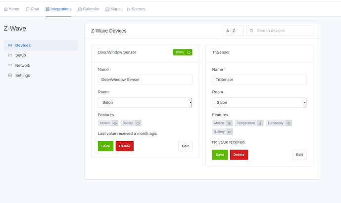

Hello everyone
I’m back for my zwave problem
The key used is: an everspring key compatible zwave and zwave plus
The key is well detected in gladys
I have 2 modules that I was able to add in gladys on this side no problem
A door opening detection module so an open or closed door state and its battery level
A triple sensor module (temperature, brightness, presence)
So here 4 data (temperature, brightness, presence and battery)
The modules are well recognized and the addition goes without errors
But the problem is that no data comes back then only the door module battery comes back only the first time during the first sync then nothing
I did various tests with firefox and chromium and waited several days (you never know) but nothing
Here, thank you for looking at the problem
