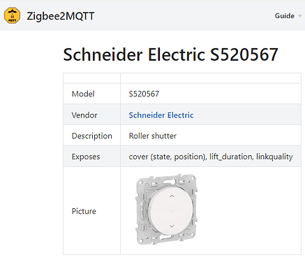

Yes, but it has a « State » too, not just position.

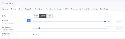

@Isage could you show us the configuration of your pool cover?
In the dashboard do you have the buttons for this feature?
My screenshots
Are you accessing Gladys locally or via Gladys Plus? Isn’t it just a cache issue after the update? Did you try simply refreshing the page?
I was indeed on Gladys Plus.
I rebooted my Raspberry Pi 4; it’s OK now.
