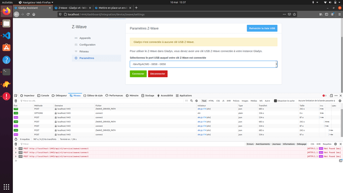

It’s done, unfortunately, it doesn’t change anything.
Yes, I also think that this is related to Gladys. I don’t know if a recent modification could have this impact.
When did you get this error?
What error are you talking about?
This one
@pierre-gilles if you can remove this limit or lower it, sometimes you have to be inventive :sweat:
Ah, when I click on connect in the configuration
http://localhost:1444/dashboard/settings/service

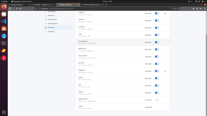

Is the zwave service active?
Don’t you have anything in the server logs?
No, but I don’t know how to activate it I must say :sweat_smile:
If it doesn’t start, you must have something in the server logs
I would have liked it to be that simple ^^
This explains the 404 error.

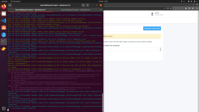

Show your server log if you please, if there are any details they are there
Is this it or are there logs elsewhere?
Yes that’s it

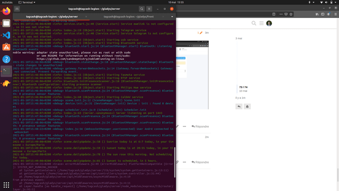

However, we should see the beginning, what happens at the start of gladys
Here you go :slight_smile: Sorry for wasting everyone’s time :frowning:
You can copy and paste the text from the console too :slight_smile: It avoids multiple captures
Yes ^^

<font color="#4E9A06">2021-05-10T15:46:06+0200 &lt;info&gt; index.js:18 (Object.start) Starting TP-Link service</font>
<font color="#4E9A06">2021-05-10T15:46:06+0200 &lt;info&gt; index.js:17 (Object.start) Starting eWeLink service</font>
<font color="#06989A">2021-05-10T15:46:06+0200 &lt;debug&gt; gateway.forwardWebsockets.js:14 (Gateway.forwardWebsockets) Gateway: not connected. Prevent forwarding event.</font>
<font color="#4E9A06">2021-05-10T15:46:06+0200 &lt;info&gt; service.start.js:40 (Service.start) Service ewelink is not configured, so it was not started.</font>
<font color="#4E9A06">2021-05-10T15:46:06+0200 &lt;info&gt; index.js:19 (Object.start) Starting Telegram service</font>
<font color="#4E9A06">2021-05-10T15:46:06+0200 &lt;info&gt; service.start.js:40 (Service.start) Service telegram is not configured, so it was not started.</font>
<font color="#4E9A06">2021-05-10T15:46:06+0200 &lt;info&gt; index.js:13 (Object.start) Starting usb service</font>
<font color="#4E9A06">2021-05-10T15:46:06+0200 &lt;info&gt; index.js:15 (Object.start) Starting Bluetooth service</font>
<font color="#06989A">2021-05-10T15:46:06+0200 &lt;debug&gt; bluetooth.start.js:14 (BluetoothManager.start) Bluetooth: Listening Bluetooth events</font>
noble warning: adapter state unauthorized, please run as root or with sudo
               or see README for information on running without root/sudo:
               https://github.com/sandeepmistry/noble#running-on-linux
<font color="#06989A">2021-05-10T15:46:06+0200 &lt;debug&gt; bluetooth.stateChange.js:10 (BluetoothManager.stateChange) Bluetooth: state changes to unauthorized</font>
<font color="#4E9A06">2021-05-10T15:46:06+0200 &lt;info&gt; index.js:15 (Object.start) Starting Tasmota service</font>
<font color="#4E9A06">2021-05-10T15:46:06+0200 &lt;info&gt; index.js:16 (Object.start) Starting RTSP service</font>
<font color="#4E9A06">2021-05-10T15:46:06+0200 &lt;info&gt; bluetooth.initPresenceScanner.js:18 (BluetoothManager.initPresenceScanner) Bluetooth configuration: starting presence scanner</font>
<font color="#4E9A06">2021-05-10T15:46:06+0200 &lt;info&gt; index.js:18 (Object.start) Starting Philips Hue service</font>
<font color="#06989A">2021-05-10T15:46:06+0200 &lt;debug&gt; bluetooth.scanPresence.js:24 (BluetoothManager.scanPresence) Bluetooth: 0 presence sensor features</font>
<font color="#4E9A06">2021-05-10T15:46:06+0200 &lt;info&gt; index.js:60 (Object.start) Starting CalDAV service</font>
<font color="#06989A">2021-05-10T15:46:06+0200 &lt;debug&gt; scene.init.js:12 (SceneManager.init) Scene.init</font>
<font color="#06989A">2021-05-10T15:46:06+0200 &lt;debug&gt; device.init.js:31 (DeviceManager.init) Device : init : Found 0 devices</font>
<font color="#06989A">2021-05-10T15:46:07+0200 &lt;debug&gt; scheduler.init.js:9 (Scheduler.init) Scheduler.init</font>
<font color="#4E9A06">2021-05-10T15:46:07+0200 &lt;info&gt; index.js:63 (Server.&lt;anonymous&gt;) Server listening on port 1443</font>
<font color="#06989A">2021-05-10T15:47:06+0200 &lt;debug&gt; bluetooth.scanPresence.js:24 (BluetoothManager.scanPresence) Bluetooth: 0 presence sensor features</font>
<font color="#06989A">2021-05-10T15:48:06+0200 &lt;debug&gt; bluetooth.scanPresence.js:24 (BluetoothManager.scanPresence) Bluetooth: 0 presence sensor features</font>
<font color="#06989A">2021-05-10T15:48:22+0200 &lt;debug&gt; index.js:56 (WebsocketManager.userConnected) User André connected in websocket</font>
<font color="#06989A">2021-05-10T15:49:06+0200 &lt;debug&gt; bluetooth.scanPresence.js:24 (BluetoothManager.scanPresence) Bluetooth: 0 presence sensor features</font>
<font color="#4E9A06">2021-05-10T15:49:08+0200 &lt;info&gt; scene.dailyUpdate.js:58 () Sunrise today is at 6:7 today, in your timezone = Europe/Paris</font>
<font color="#4E9A06">2021-05-10T15:49:08+0200 &lt;info&gt; scene.dailyUpdate.js:59 () Sunset today is at 20:55 today, in your timezone = Europe/Paris</font>
<font color="#4E9A06">2021-05-10T15:49:08+0200 &lt;info&gt; scene.dailyUpdate.js:70 () The sun rose this morning. Not scheduling for today.</font>
<font color="#4E9A06">2021-05-10T15:49:08+0200 &lt;info&gt; scene.dailyUpdate.js:81 () Sunset is scheduled, in 5 hours.</font>
<font color="#75507B">2021-05-10T15:49:31+0200 &lt;trace&gt; errorMiddleware.js:49 (errorMiddleware) PlatformNotCompatible [Error]: SYSTEM_NOT_RUNNING_DOCKER</font>
<font color="#75507B">    at System.getContainers (/home/tagcash/gladys/server/lib/system/system.getContainers.js:13:11)</font>
<font color="#75507B">    at getContainers (/home/tagcash/gladys/server/api/controllers/system.controller.js:31:44)</font>
<font color="#75507B">    at /home/tagcash/gladys/server/api/middlewares/asyncMiddleware.js:4:19</font>
<font color="#75507B">From previous event:</font>
<font color="#75507B">    at /home/tagcash/gladys/server/api/middlewares/asyncMiddleware.js:4:11</font>
<font color="#75507B">    at Layer.handle [as handle_request] (/home/tagcash/gladys/server/node_modules/express/lib/router/layer.js:95:5)</font>
<font color="#75507B">    at next (/home/tagcash/gladys/server/node_modules/express/lib/router/route.js:137:13)</font>
<font color="#75507B">    at /home/tagcash/gladys/server/api/middlewares/authMiddleware.js:28:7</font>
<font color="#06989A">2021-05-10T15:49:56+0200 &lt;debug&gt; index.js:56 (WebsocketManager.userConnected) User André connected in websocket</font>
<font color="#06989A">2021-05-10T15:50:05+0200 &lt;debug&gt; index.js:80 (WebsocketManager.userDisconnected) User André connected in websocket</font>
<font color="#06989A">2021-05-10T15:50:06+0200 &lt;debug&gt; bluetooth.scanPresence.js:24 (BluetoothManager.scanPresence) Bluetooth: 0 presence sensor features</font>
<font color="#06989A">2021-05-10T15:50:07+0200 &lt;debug&gt; index.js:56 (WebsocketManager.userConnected) User André connected in websocket</font>
<font color="#06989A">2021-05-10T15:51:06+0200 &lt;debug&gt; bluetooth.scanPresence.js:24 (BluetoothManager.scanPresence) Bluetooth: 0 presence sensor features</font>
<font color="#06989A">2021-05-10T15:52:06+0200 &lt;debug&gt; bluetooth.scanPresence.js:24 (BluetoothManager.scanPresence) Bluetooth: 0 presence sensor features</font>
<font color="#06989A">2021-05-10T15:53:06+0200 &lt;debug&gt; bluetooth.scanPresence.js:24 (BluetoothManager.scanPresence) Bluetooth: 0 presence sensor features</font>
<font color="#06989A">2021-05-10T15:54:06+0200 &lt;debug&gt; bluetooth.scanPresence.js:24 (BluetoothManager.scanPresence) Bluetooth: 0 presence sensor features</font>
<font color="#06989A">2021-05-10T15:55:06+0200 &lt;debug&gt; bluetooth.scanPresence.js:24 (BluetoothManager.scanPresence) Bluetooth: 0 presence sensor features</font>
<font color="#06989A">2021-05-10T15:56:06+0200 &lt;debug&gt; bluetooth.scanPresence.js:24 (BluetoothManager.scanPresence) Bluetooth: 0 presence sensor features</font>
<font color="#06989A">2021-05-10T15:57:06+0200 &lt;debug&gt; bluetooth.scanPresence.js:24 (BluetoothManager.scanPresence) Bluetooth: 0 presence sensor features</font>
</pre>
Want me to guess? :smiley:
Edit: the npm package for the zwave service is not installed, probably because you didn’t have the correct library installed.
Run an npm install in the zwave folder and verify that the compilation passes.
