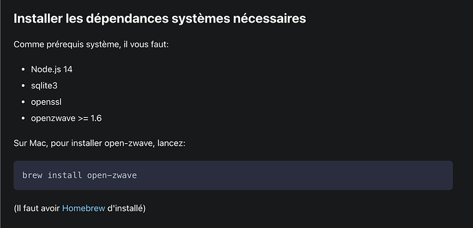

@tagcash For your information, I have updated the documentation with what we discussed yesterday!
