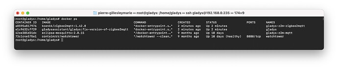

Tested successfully on my machine:
2024-12-06T14:23:28+0100 \u003cinfo\u003e init.js:63 (Zigbee2mqttManager.init) Zigbee2mqtt USB dongle attached to /dev/ttyUSB0
2024-12-06T14:23:28+0100 \u003cinfo\u003e checkForContainerUpdates.js:14 (Zigbee2mqttManager.checkForContainerUpdates) Checking for current installed versions and required updates...
2024-12-06T14:23:28+0100 \u003cinfo\u003e checkForContainerUpdates.js:40 (Zigbee2mqttManager.checkForContainerUpdates) Z2M container: update #4 of the container required...
2024-12-06T14:23:28+0100 \u003cinfo\u003e checkForContainerUpdates.js:57 (Zigbee2mqttManager.checkForContainerUpdates) Z2M container: update #4 of the container done
2024-12-06T14:23:28+0100 \u003cinfo\u003e installMqttContainer.js:114 (Zigbee2mqttManager.installMqttContainer) MQTT broker container successfully started
2024-12-06T14:23:28+0100 \u003cinfo\u003e installZ2mContainer.js:50 (Zigbee2mqttManager.installZ2mContainer) Zigbee2mqtt is being installed as Docker container...
2024-12-06T14:23:28+0100 \u003cinfo\u003e installZ2mContainer.js:51 (Zigbee2mqttManager.installZ2mContainer) Pulling koenkk/zigbee2mqtt:1.42.0 image...
2024-12-06T14:23:29+0100 \u003cinfo\u003e installZ2mContainer.js:54 (Zigbee2mqttManager.installZ2mContainer) Configuration of Device /dev/ttyUSB0
2024-12-06T14:23:29+0100 \u003cinfo\u003e installZ2mContainer.js:59 (Zigbee2mqttManager.installZ2mContainer) Creation of container...
2024-12-06T14:23:29+0100 \u003cinfo\u003e installZ2mContainer.js:62 (Zigbee2mqttManager.installZ2mContainer) Zigbee2mqtt successfully installed and configured as Docker container
2024-12-06T14:23:29+0100 \u003cinfo\u003e configureContainer.js:23 (Zigbee2mqttManager.configureContainer) Z2M Docker container is being configured...
2024-12-06T14:23:29+0100 \u003cinfo\u003e configureContainer.js:36 (Zigbee2mqttManager.configureContainer) Z2M configuration file already exists.
2024-12-06T14:23:29+0100 \u003cinfo\u003e installZ2mContainer.js:84 (Zigbee2mqttManager.installZ2mContainer) Zigbee2mqtt container is (re)starting...
2024-12-06T14:23:34+0100 \u003cinfo\u003e installZ2mContainer.js:90 (Zigbee2mqttManager.installZ2mContainer) Zigbee2mqtt container successfully started
2024-12-06T14:23:34+0100 \u003cinfo\u003e connect.js:25 (Zigbee2mqttManager.connect) Connecting Gladys to mqtt://localhost:1884 MQTT broker...
2024-12-06T14:23:34+0100 \u003cinfo\u003e connect.js:35 (MqttClient.\u003canonymous\u003e) Connected to MQTT container mqtt://localhost:1884
2024-12-06T14:23:34+0100 \u003cinfo\u003e subscribe.js:12 (Zigbee2mqttManager.subscribe) Subscribing to MQTT topic zigbee2mqtt/#
And here’s the result:
