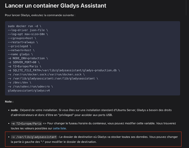

I found the tutorial and followed it: Tutoriel: Lancer une image Docker de test
I followed the tutorial and installed the test image by doing this:
sudo docker run -d \
--log-driver json-file \
--log-opt max-size=10m \
--cgroupns=host \
--restart=always \
--privileged \
--network=host \
--name gladys-zigbee2mqtt-tuya-me201wz-test \
-e NODE_ENV=production \
-e SERVER_PORT=8001 \
-e TZ=Europe/Paris \
-e SQLITE_FILE_PATH=/var/lib/gladysassistant/gladys-production.db \
-v /var/lib/gladys-zigbee2mqtt-tuya-me201wz-test:/var/lib/gladysassistant \
-v /dev:/dev \
-v /run/udev:/run/udev:ro \
gladysassistant/gladys:zigbee2mqtt-tuya-me201wz
I made sure to change the port and the storage space.

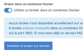

The instance is accessible on port 8001, no problem. But where I started having issues was with the MQTT broker and Zigbee2MQTT that I wanted to connect to the test instance. I thought that both Gladys instances could be connected to these containers but when I enable it on one it disconnects the other, it seems..
So for now I’ve stopped the test instance to avoid risking my production :slight_smile:

First, for your question :
Your container named gladys-z2m-mqtt is your MQTT instance which is based on the eclipse-mosquitto image, so it’s normal that they have the same size.
Regarding your procedure, everything is perfect up until the moment of adding MQTT to your test Gladys.
I think you enabled MQTT like this :

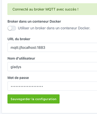

But you need to uncheck the option and enter the parameters which should be these :
To find your MQTT password and username (and maybe the server), I’ll let you see @pierre-gilles’s explanation here

Thanks so much @mutmut and @_Will_71, I managed to launch a test instance in parallel on the same PC and I’m using the same zigbee2mqtt and broker as production. It’s perfect — messages are arriving fine in both instances :slight_smile:
