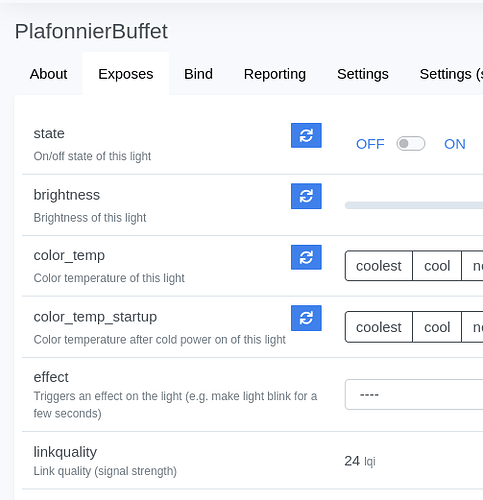

Great idea to generate the features from the library code, I hadn’t thought of that. I had stopped at the fact that these JSON files did not contain the exposed features.
But as @pierre-gilles said, might as well go further and do it on the fly.
I don’t have much time to look at this week, but if you propose a PR, I’ll take some time in the coming weeks to look at it.
@cicoub13 the generated ones from your payload come from changes in Gladys, generation on the fly.
Once the devices are correctly generated, I will propose a test image to validate the integration with MQTT.
My first task, generate the devices / features according to the data received dynamically.
