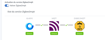

I don’t know if this is normal but this weekend I rebuilt my NUC BT3Pro to install a clean, up-to-date version of Linux Lite
I reinstall everything then bring Gladys back up, I do a Gladys restore and everything is ok
then I bring up lokkie’s test image for node-red; I can access it fine, everything ok I go to the integrations page zigbbe2mqtt ok mqtt ok
I go back to Gladys — no more zigbee2mqtt nor mqtt — and then I try to restart the services mqtt zigbbe2mqtt and nothing works
I stop @lokkie’s Gladys image but that changes nothing when looking at the container settings in Portainer
I end up with this
Apparently this created a problem by having launched @lokkie’s image with these settings and afterwards the normal Gladys instance apparently can’t find its bearings anymore!
After stopping @lokkie’s image then removing the zigbee2mqtt and mqtt containers and their volumes with Portainer, I reactivate the zigbee2mqtt and mqtt services in Gladys and everything works again!

More seriously, I also have a Sonoff P dongle and I also had /dev/ttyACMO then rebooted the NUC and then dongle /dev/ttyUSB with dongle detected service active but instead of green checkmarks there were red crosses
and as I wrote in the previous message I had both instances running
gladys with the key recognized service active but red crosses
gladys-test-nodered:8010 with the key recognized service active but a green check
in both cases the volumes pointed to the directory /var/lib/gladys-test-nodered, impact or no impact on the bug or @cicoub13’s config I’m only reporting what I observed!
I just wanted to bring this additional info regarding this parameter change in case @cicoub13 also tested @lokkie’s image, I know there’s an additional bug related to Synology but since there are similarities between what I encountered and the issue this topic is about, I thought « you never know » and if it’s not the case well how would we know if we don’t mention it!!! :wink: And at first I thought my install or my key was corrupted, it’s thanks to Portainer that I saw this incorrect volume parameter in Gladys. :blush:
