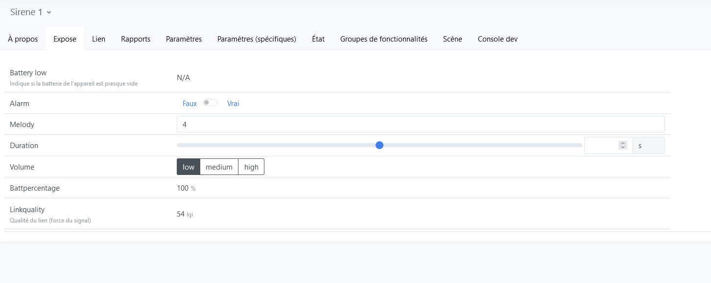

I have a Neo bought on AliExpress and its expose looks like this :

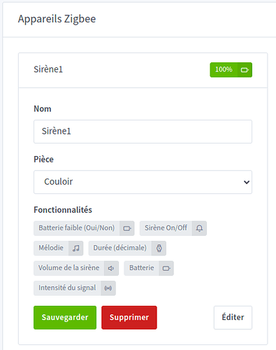

et dans zigbee2mqtt de Gladys, j’ai ça :
I don’t have the melodies command — I can only trigger them and set the duration of the signal.
Did you go to Zigbee Discovery in the Gladys integration to update your siren?

This concerned the addition of features for a zigbee2mqtt device, so it was necessary to manually update the zigbee2mqtt integration.
