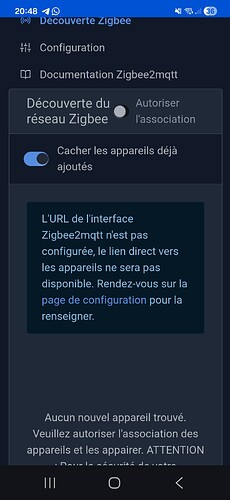

Good evening,
I’m having an issue with this message: „The Zigbee2mqtt interface is not configured“
So, did you go to the configuration page as requested? Just so you know, it’s optional.
But given the red message, I’d rather refrain from starting over

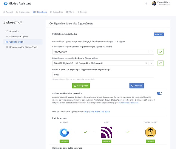

@Will_71 I wonder if there isn’t an issue with Gladys Plus as I’m getting the same message on my end as well (on Gladys Plus), even though I’ve correctly configured the URL locally.
On Gladys Plus, we don’t actually display the links, I think, so shouldn’t we also not display the message?
Weird, I just launched Gladys Plus and I don’t have the message.
By forcing a page refresh on my phone, I see the message but it disappears immediately.

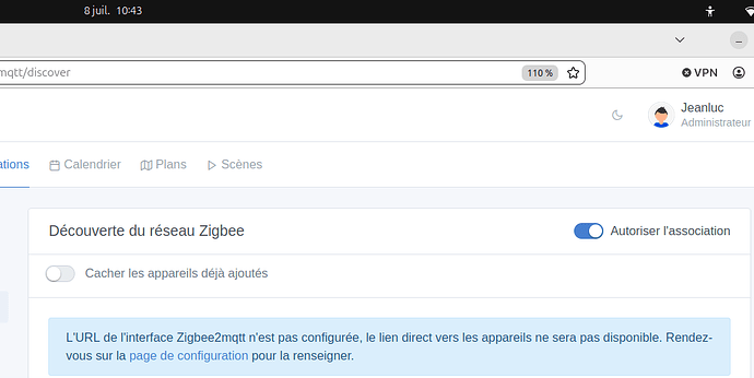

Maybe it was me who broke something with this PR (Zigbee2mqtt: Display credentials in UI by Pierre-Gilles · Pull Request #2583 · GladysAssistant/Gladys · GitHub) but I no longer have the parameter locally either, even though I am indeed using the latest version of Gladys…
I am indeed on 4.81.0:
Does it work for you @Will_71?
I’m on the same version and it works for me.
I’m still getting the same message:
