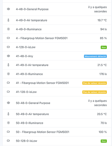

Just to be sure: does line 41-48-0-Any switch to « X minutes ago » mode at some point or not? Or does it stay stuck on « Movement detected »?
Thanks @mutmut
yes it switches back to « il y a xx minutes » (« xx minutes ago ») after a 30s delay for me.
For the other two, it may be that the report hasn’t come through yet. I have the battery of 41 that no longer reports anything now; I had to set a parameter to not report the battery if there’s no change to avoid draining the battery too quickly.
Could you give me the list of events for the two devices in question?

That’s exactly what I thought, we had to wait, and I also changed the battery of the 4 (85%):
However, if there is no change in values, I get a « no value » in Gladys, it seems.
How can we change that? (I’m having some difficulty understanding the subtleties of MQTT configuration)

However, if there is no change in values, I seem to get a « no value » in gladys.
This is a more general behavior that I also observe on my side. We could try to look into it by initializing Gladys’ state with the latest known data from the DB or via the info received during the initialization of Glays => for me that’s a whole different topic on a completely different PR (I’ll note the point, I know exactly what you’re talking about, I have the same issue… not only with zWave, Zigbee too).
I think we can therefore consider the PR as OK and functional. @pierre-gilles what do you think?

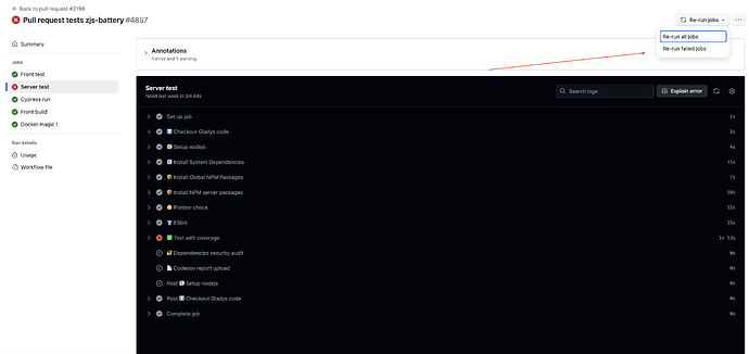

The test failure is not related to the PR’s changes:
They just need to be retried (I don’t think I can do that on my side… tell me if I can, it would avoid bothering you if it happens again).

For the tests, I re-ran by clicking here:
