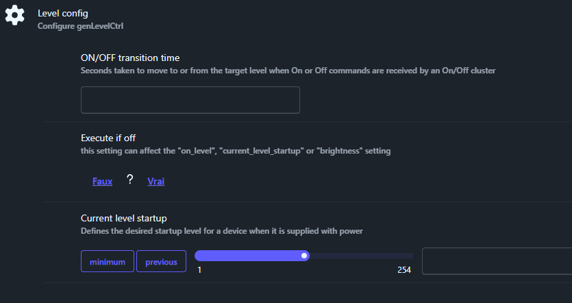

However, there is indeed another possibility with the following exposes:
but I assume they are not included in Gladys and I need to use Node-RED?

To answer your question: you’re right, these exposes are not taken up in Gladys. The Zigbee2MQTT service converts the exposes into Gladys features via an explicit mapping (state, brightness, color_temp, temperature, humidity, etc.), and anything outside this list is ignored. level_config is part of it: it’s a composite object of parameters, and today Gladys only manages composites for color.
On the other hand, no need for Node-RED. Two options:
1. The simplest: set it once in the Zigbee2MQTT interface. These values are stored in the bulb itself, not in z2m. You go to the Exposes tab of your bulb in the Z2M UI, you set your on_level (or you activate execute_if_off), and that’s it: Gladys doesn’t need to know, the behavior changes for everyone, including your existing scenes.

Two warnings about these attributes: execute_if_off and on_level are optional in the Zigbee spec, not all bulbs implement them (and some accept them without applying them). The fact that z2m displays them in the exposes is a good sign but not a guarantee: test before building your entire logic on them.
