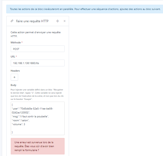

I created and entered the UUID key in Node-RED and in my scene.
I’m getting this error message
Any idea what the problem is?
Thanks
I think you forgot « http:// » in the URL
That’s right. You need to add http:// before the IP address.
I just edited the tutorial.
I made the change in my scene, but I still get the same message

By any chance the last empty line before the brace might be causing a problem, maybe if the algorithm that processes the JSON tries to interpret the line…

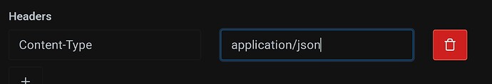

Reformat your JSON with tools that validate it, such as
Remember to also add the Content-Type header as
application/json

Sorry but I don’t understand: « add the Content-Type header also as
application/json »

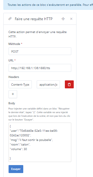

Did you click save or try?
Because try doesn’t work for that.
You need to save and launch your scene.
Normally it’s when you retrieve a variable that the try function doesn’t work.
I had clicked on « try »
Je viens de cliquer sur « Save » et ensuite sur "start => nothing happens.
@Spencer told me to « think about adding the Content-Type header also as
application/json ». Unfortunately, I don’t understand what needs to be done, and how…
@Isage
you need to click on the + and add
'content-type:application/json'
Exactly
Like this:
It’s done, but nothing happens when I click on « Start »
What did you do on the Node-

Here are my screenshots
![2|596x309](upload://
I forgot this screen
