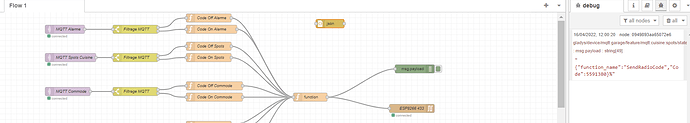

Here is the part of the flow:
a = ‹ « SendRadioCode » ›
msg.payload=« {"function_name":" » + a + « ","Code":" » + msg.payload + « "}% »;
return msg;
which gives a send of this type:
« {"function_name":"SendRadioCode","Code":5588308}% »

Hi @pierre-gilles, the same thing happens when I connect the Arduino to a local NodeRed.
Reception is fine with button modification in Gladys via MQTT, but transmission does not work.
« {"function_name":"SendRadioCode","Code":5591380}% »
The message is sent to the Arduino and the LED connected to the transmitter blinks, but the 433 devices do not react.
The format of the sent code seems to respect the one expected by the Arduino since the LED blinks, but it is impossible to know where it is stuck.

Add logs in Node-RED to see the payload sent :slight_smile:
Sorry but I don’t know how to do that .. :unamused:
Watch my video about Node-RED on YouTube, I show how to do it in there :slight_smile:
@pierre-gilles, I reviewed your very instructive video.
I didn’t realize, but in fact the logs you’re talking about correspond to the debug.
I’ve been using it since the beginning to see where it’s stuck.
Well, I’m really a fool. I just realized I had a capitalization problem in the « Code » while the Arduino was expecting « code ». I wasn’t rigorous enough about the case of the values :unamused:
