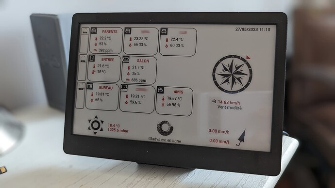

Here is the result. I don’t have time to do more at the moment so the display is not standalone (mains-powered) and I’m not entirely happy with the interface.
The hardware:
You can find the whole setup on Amazon for around €90.
The information displayed comes almost entirely from Gladys except for those relating to wind speed and direction and the weather icon in the bottom left.
Thanks again for your help on the DEV side :wink:
If you have any suggestions on how the displayed information could be better presented, I’m all ears!

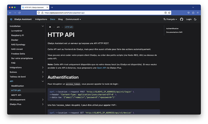

By the way, thanks @cicoub13 for the additional explanation about the Gladys HTTP API :slight_smile:
I took inspiration from your post to improve the documentation on the website!
Read it here:
I also took the opportunity to update the package « apidoc » to get the latest UI, and I restored the build process in the API documentation which was apparently broken. From now on, with each Gladys release, a new build will be done on Cloudflare Pages automatically.

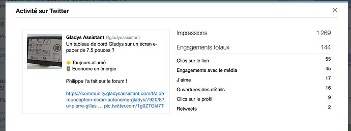

Anyway @PhilippeMA, your project blew up on social media; it’s one of the best posts of the year and had a record engagement of 11% (I’ve rarely seen that)
55 clicks on the link, that’s a lot compared to other posts :grin:
