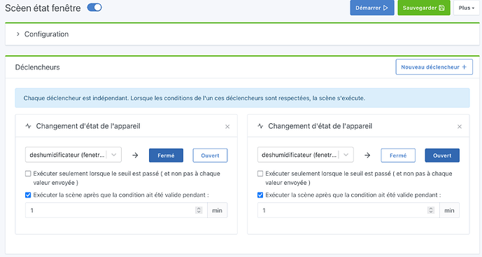

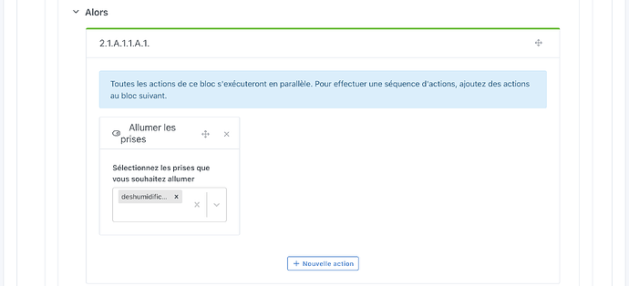

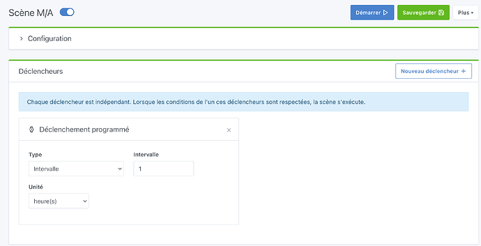

Scene On/Off

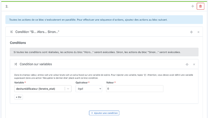

Window state scene
Heads-up about the scenes — if it seems complicated, that’s my brain wanting it that way :rofl:

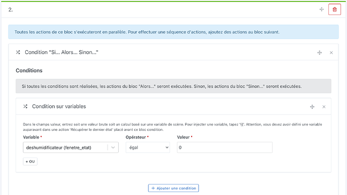

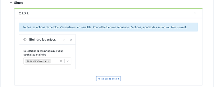

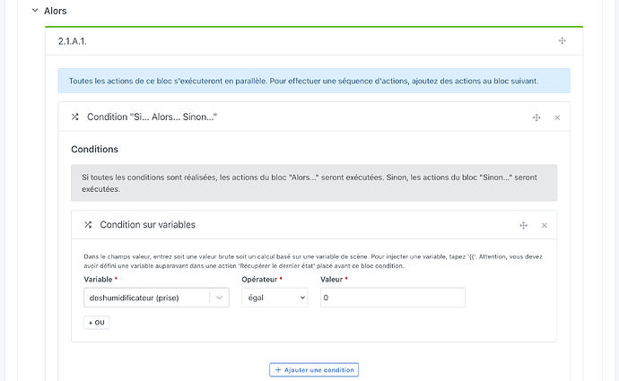

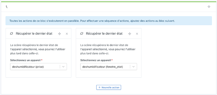

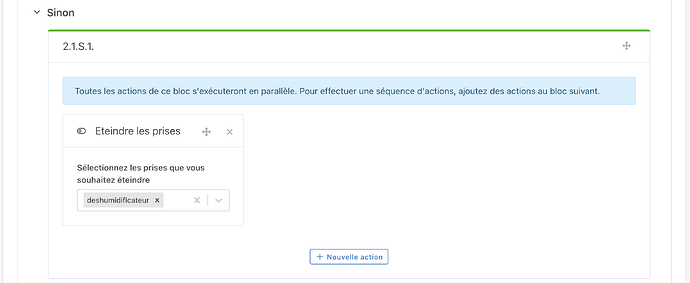

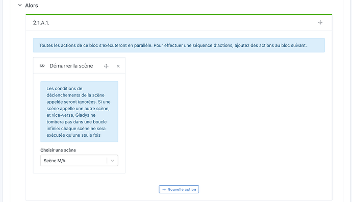

Be careful about the level where you put your actions, especially for the Sinon of the Scene On/Off.
Another point: you’ll need to check whether 0 and 1 represent the window open state (0 = open or closed?) and adjust accordingly (I assumed 0 = closed in my scenario).
There’s a way to put everything into a single scene but be careful — it can be brain-twisting!

It’s an example I took with a virtual device and you need to check yours to know which value to retrieve when it’s closed.
In my case, my open/close sensors use contact detection so if there is contact (true, =1) then they are closed, and if there is no contact (false, =0) then it’s open.
And indeed, every hour we retrieve the state of the plug and we « invert » its state.
And if the window is open then we force the plug to switch off.
