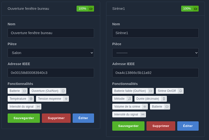

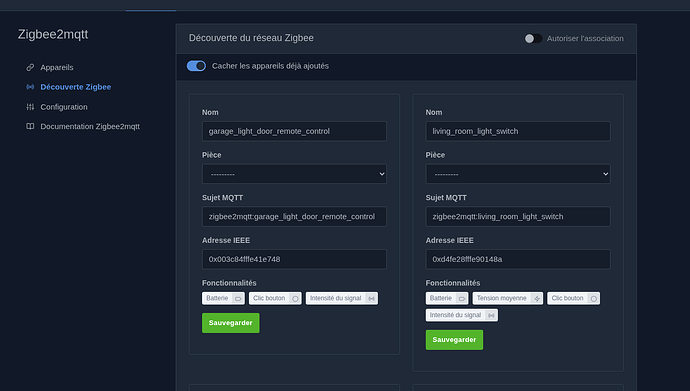

### Pull Request check-list
To ensure your Pull Request can be accepted as fa⊠st as possible, make sure to review and check all of these items:
- [x] If your changes affect the code, did you write the tests?
- [x] If you are adding a new feature/service, did you run the integration comparator? (`npm run compare-translations` on front)
- [x] Did you test this pull request in real life? With real devices? If this development is a big feature or a new service, we recommend that you provide a Docker image to the community ([forum](https://community.gladysassistant.com/)) for testing before merging.
- [x] If your changes modify the API (REST or Node.js), did you modify the API documentation? (Documentation is based on comments in code)
- [x] If you are adding a new features/services which needs explanation, did you modify the user documentation? See [the GitHub repo](https://github.com/GladysAssistant/v4-website) and the [website](https://gladysassistant.com).
- [x] Did you add fake requests data for the demo mode (`front/src/config/demo.js`) so that the demo website is working without a backend? (if needed) See [https://demo.gladysassistant.com](https://demo.gladysassistant.com).
### Description of change
add IEEE address and link to open Z2M on device & discover page
https://community.gladysassistant.com/t/ajout-de-lid-zigbee2mqtt-dans-la-configuration-des-appareils/9616
<img width="282" height="374" alt="image" src="https://github.com/user-attachments/assets/7a89fc30-878e-4a0e-89d5-4ff9c3b3cb07" />
## Summary by CodeRabbit
* **New Features**
* Show IEEE addresses for Zigbee2MQTT devices on device and discovery pages.
* Add a setup field to configure the Zigbee2MQTT frontend URL.
* Provide quick links (with a small logo) to open devices in the Zigbee2MQTT web UI when available.
* **Translations**
* Added German/English/French labels and placeholders for the frontend URL and IEEE address UI.

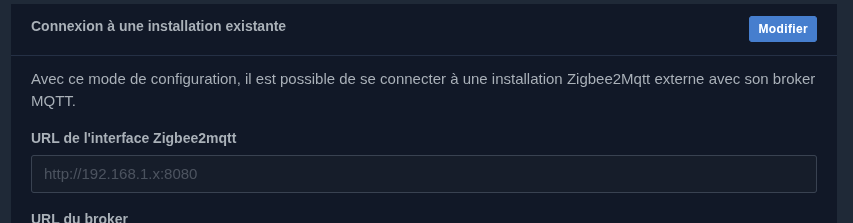

With a copy of my database, thereâs no issue either, my devices are displayed correctly. Just the link is not displayed because the URL is not configured
Maybe the problem is because on my side I use an external broker and you use a USB dongle configured in Gladys?

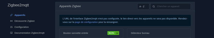

Hereâs the message I added
I pushed a fix and added the message. Iâm also rebasing with the latest release.
Could you retest on your side and let me know
Edit : I noticed the tests didnât pass. Iâll look into it later.
Thanks for your feedback, Iâll let you know as soon as Iâve been able to test it!
I had already tested in external mode on my production Zigbee2MQTT, so itâs normally not that. After, I might have just made a bad move Iâll take a look!
@Will_71 Thanks for adding the banner, I find it much clearer now!
