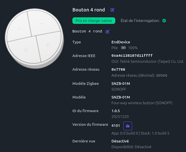

I bought this nice 4-button wall switch (SONOFF - 4-Button Zigbee Remote / Wall Switch SNZB-01M Orb 4-In-1) and I had no problem getting it recognized on Zigbee2MQTT.

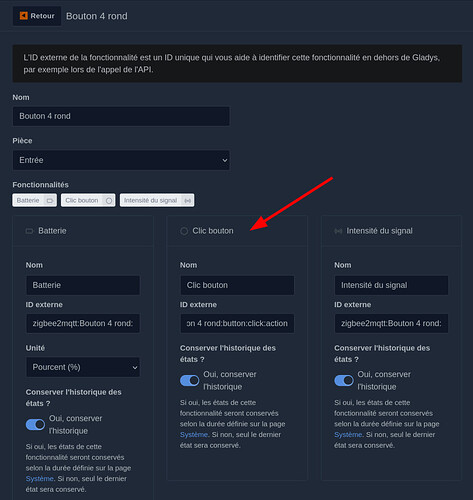

However, in Gladys, I only see one button out of the four and in fact, it doesn’t work in the scenes.
Is there a solution to fix this problem?
Thanks a lot.
Laurent

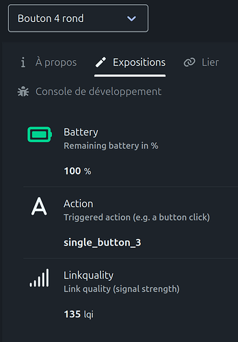

Actually, there’s no issue
What sets your 4 buttons apart is the value they send, like:
button_1_single
button_1_long
button_2_double
etc
So your button is perfectly functional, I have the same type of Aqara switch

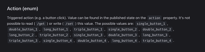

Hi @LaurentGui
I found your button on the Zigbee2mqtt website:
Apparently, it’s normal that it only exposes one « action » button click:
Then, you have plenty of types of actions that you can normally use in scenes.
If you want to see all the types of actions your button exposes, you can add this « Button Click » feature to the dashboard, and press each button one by one, and you should see the button display change each time.
If that’s not the case, it’s possible that we’re missing some types of action in Gladys, and in that case, I’ll add them
