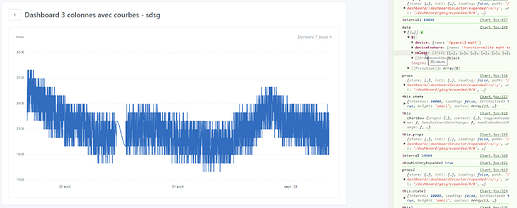

However we lose so much space
The performance is completely different with DuckDB:

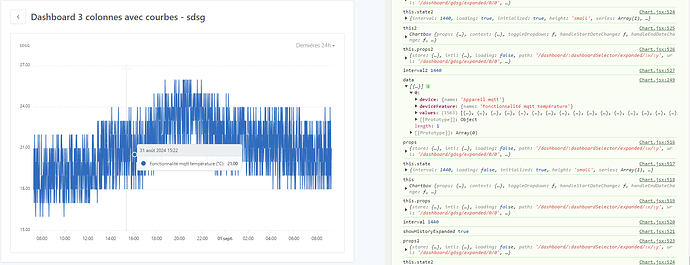

1 hour = 184 states
moving to 24h = 1560 states
moving to 7 days = 3700 states

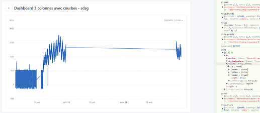

moving to 3 months = 37300 states (well, however navigation at that stage becomes problematic) and if multiple devices itâs rough.

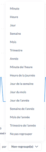

A selection dropdown for display by aggregate (like on Metabase)

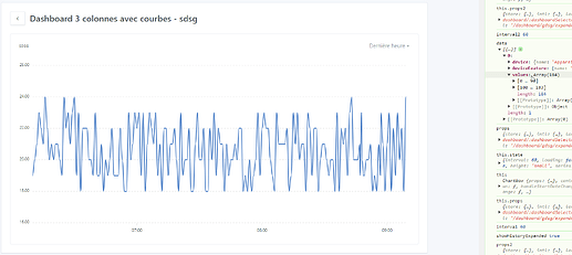

Why not just set a limit everywhere? 4000 points seems excessive to me though, currently on the dashboard we display 200
Yes! but still with the same limit
Actually you just need to keep exactly the same query as on the dashboard, but request more points, and have the ability to specify a period and not just a duration
Yes, absolutely!
Perfect
Okay, I see how it looks with 1000 points.

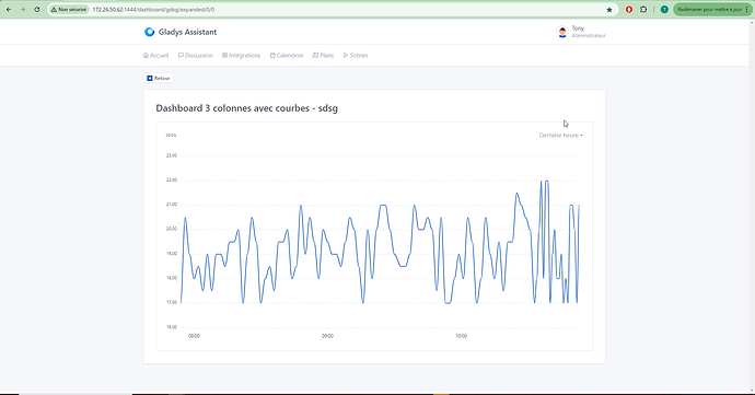

guim31:
Yes, I understood that, but Iâm still impatient. Actually, I find that the chart display part mainly needed the ability to show them larger, and this is perfect for me!
Between that and the binary sensors, Iâm thrilled with these latest devs!!
PR to choose the number of columns on the dashboard in the Gladys Plus test at https://terdious-add-choice-number-col.pages.dev/ for those interested!!^^
And finally the expanded view of the charts
