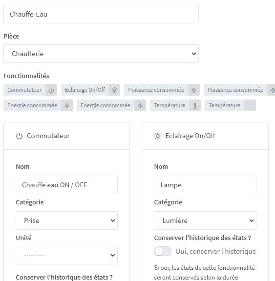

I tried it on the Dashboard and the problem is partially resolved. Actually it all depends on the configuration.
For my part I have a SONOFF dual relay flashed with Tasmota.
On it I have my water heater and a light. So I configured an outlet and a light.
In that case the defined names are not taken into account.
In the Dashboard I have the device name for both contacts
But if I change it and, instead of the lamp, define an outlet, then the Dashboard display is correct.
Normally only identical features are considered.
Mmm indeed, because the code only applies this rule to « complex » devices that have multiple features of the same type, whereas here you change the type and so the display considers them as two different features, therefore distinguishable in the UI!
How to do it? :thinking: If anyone has an idea, I have no answer at all.
Ok at first I didn’t understand why it worked for @Psoy and not for me.
And it was when I saw the configuration of my relay that I understood. Hence my message to point it out
After that I absolutely don’t mind configuring the lighting as an outlet!
Should we take only the type and not the category?

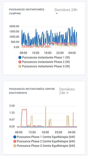

I’ve also tried to fix the charts.

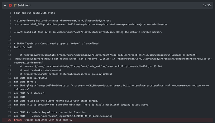

@AlexTrovato The PR doesn’t seem to be passing:

Indeed, I hadn’t taken the thermostat’s new box into account.
I’ve just fixed it (rebased everything from master).

Regarding the graphs, they look fine on my end:
And everything else is still working.
Thanks @AlexTrovato and @pierre-gilles
(I don’t have the screenshot but it’s also all good when clicking on the graph)

Works for me, you can merge.
The curves are fine with me as well
