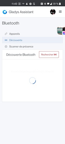

I’m having a small Bluetooth issue. Bluetooth no longer finds anything in the scan, and I’ve been away with my wife for 5 days from home ^^'.
In the logs, I don’t see anything, but here is the infinite loop when I go to the discovery section:
Any ideas?

No logs in the web inspector, network side:
The spinner does not stop despite the API response and the message « no Bluetooth device detected » is displayed but very barely visible.
