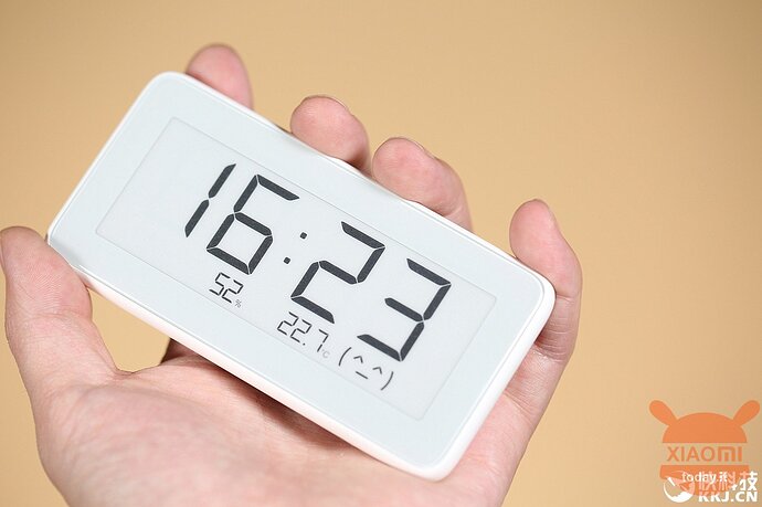

Out of curiosity, can this service be used to retrieve information from this Xiaomi sensor?
I can’t confirm that for you, I haven’t studied the matter, but to not forget, you can always create an issue on the GitHub of the small program.
I would tell you to try it, but there are a few manipulations to activate Bluetooth under npm, so I need to complete the documentation and fix a first bug.
