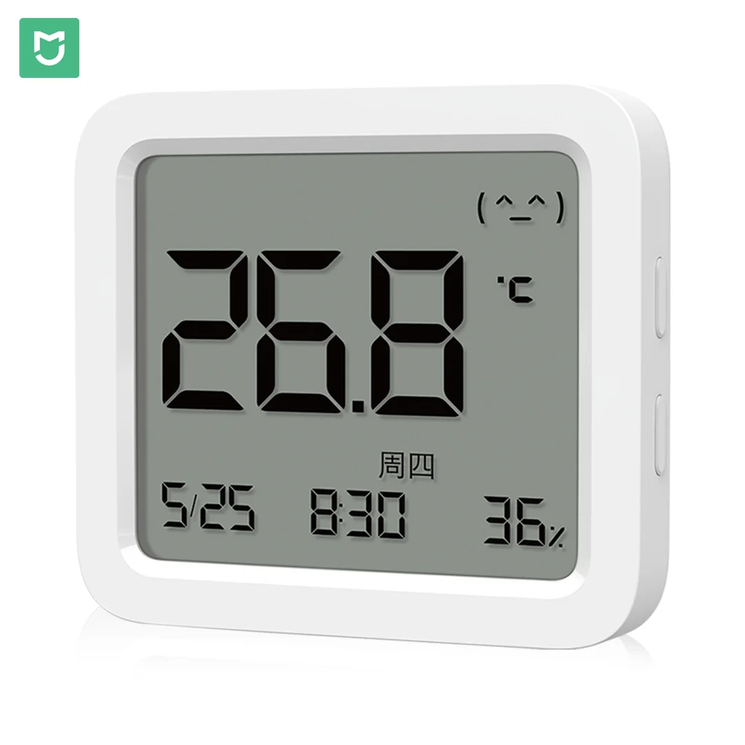

Just a topic to work on the Bluetooth recognition of my Xiaomi hardware.
I am available for logs (need to remind me of the commands…)
These are the temperature and humidity monitors with display.

As I mentioned earlier, I have 4 temperature and humidity monitors.
They appear in the Bluetooth devices (with two identifiers each, one without characters and one with just the battery) except 1 which must be out of range.
