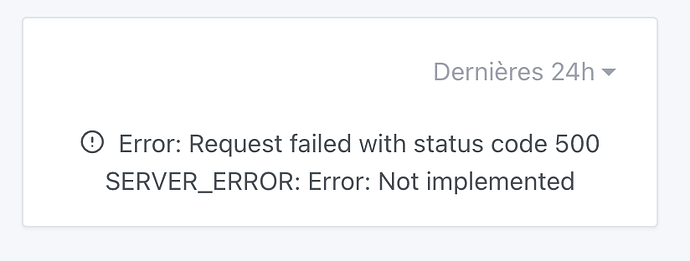

Bug in dashboard chart "Group by" with identical values
Good evening,
I’m submitting what I think is a bug :sweat_smile:

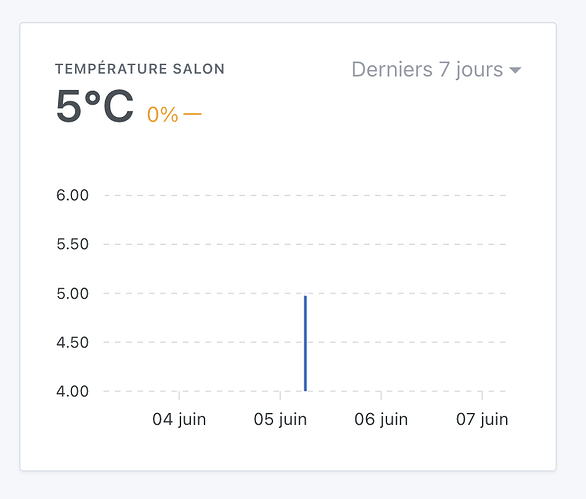

In fact, when I create a chart of this type with this device in particular:
And when I save the page, the data is saved correctly but I then end up on a page like this which stays stuck:
I can press back in the browser and return to the edit window, and when I select « Do not group »:
And when I save the page, the data is saved correctly and I get to my page properly loaded:
The other charts are configured the same with grouping by hour and those work fine.
The only difference is that the value hasn’t changed for a while on this sensor (I will investigate because that’s not normal), but I think the problem comes from here :thinking:
Thanks :slightly_smiling_face:

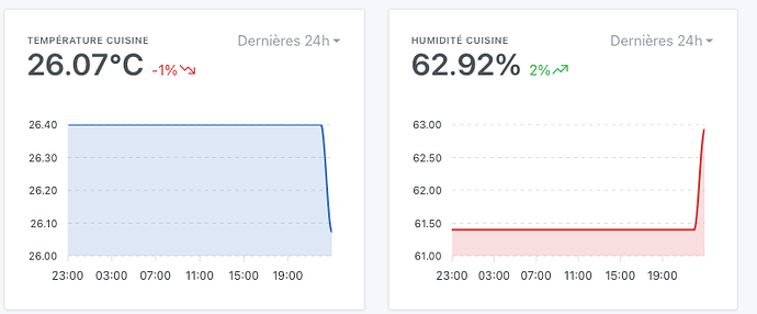

Edit: I was able to fix my value sending problem by reintegrating the module.
A new value was sent and I was able to restore grouping by hour and it’s OK

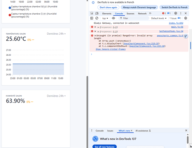

Thanks for the reply! If you can reproduce it, do you see the error in the browser console? (Right-click → Inspect → Console)
Otherwise, I’ll try to reproduce it :slight_smile:
I couldn’t reproduce the bug under the same conditions, but I got this:

apexcharts.common.js:6 Uncaught (in promise) RangeError: Invalid array length
    at Array.push (<anonymous>)
    at e.value (apexcharts.common.js:6:166933)
    at e.value (apexcharts.common.js:6:168998)
    at e.value (apexcharts.common.js:6:175666)
    at e.value (apexcharts.common.js:6:171632)
    at e.value (apexcharts.common.js:6:427093)
    at e.value (apexcharts.common.js:14:38538)
    at e.create (apexcharts.common.js:6:5550)
    at apexcharts.common.js:14:37073
    at new Promise (<anonymous>)
    at e.value (apexcharts.common.js:14:21768)
    at t.c.displayChart (ApexChartComponent.jsx:218:18)
    at t.c.componentDidMount (ApexChartComponent.jsx:222:10)
    at index.js:358:8
    at Array.some (<anonymous>)
    at index.js:356:16

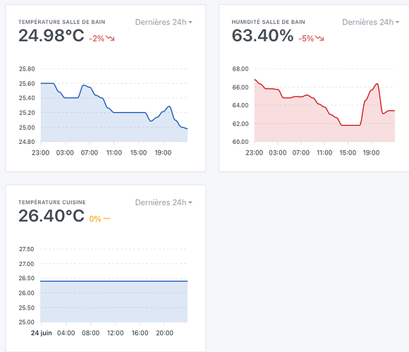

Right now I can’t reproduce the problem ^^
Did you try having a single value in the graph, I suppose, and grouping it by hour?
Otherwise I’ll see when the PR is in Prod if it shows me an error message :innocent:
Yes! I tried several cases: no values and with a single value.

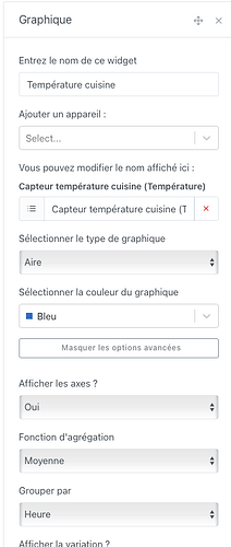

I was able to reproduce the problem as follows:
Here I selected a temperature sensor on a probe that detects if there is a water leak (Water Leak Sensor (Temperature))
Adding a chart.
Select a device with a temperature that has only one value
Select chart type: Area
Show axes: Yes
Aggregation function: Average
Group by: Hour (Also tested with Do not group)
Show variation: Yes
Default interval: 24h
And Save

In my opinion it’s something else, you just haven’t selected a chart type, apparently? [2][4].chart_type\\\" is not allowed to be empty
That doesn’t look like the error you had before
Indeed, sorry :frowning:
I can’t reproduce the issue again at the moment
However, whenever I save I get quite a few errors like this, even though it doesn’t reproduce the bug:
    "status": 500,
    "data": {
        "status": 500,
        "code": "SERVER_ERROR",
        "error": {}
Do you have, in the « Network » tab, the request that shows this error?
In the Network tab I don’t have a 500 status code:
But I do have the message in the console
