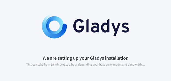

During the container creation phase, a waiting page is available at http://PI.IP or http://gladys

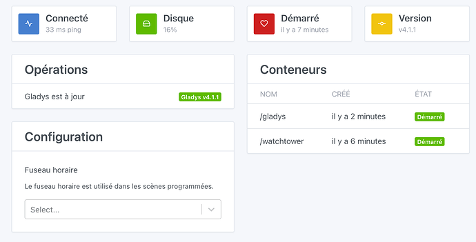

Hello. I tested this morning with an RPI3A+ and it worked on the first try :muscle:
About 1 minute before the page is displayed:
Then 4-5 minutes to download Gladys and install it (directly in the latest version :heart_eyes:)
Just a small detail, I have the impression that the waiting page refreshes itself, but there is a moment (I think when the Gladys image starts) where the page displays an error. You then need to manually refresh. I think it’s going to be hard to do better.
Yes, I set an auto-refresh so that it lands on Gladys when the container is destroyed (60 seconds), maybe I should increase that. You must have hit the exact moment when the waiting container is destroyed and Gladys isn’t fully up (play the lottery because it’s a matter of seconds ^^)

Wouldn’t you want to make a GET request in JS without refresh to avoid the user ending up on a « broken » page?
For example, you poll the Gladys endpoint every 10 seconds to see if it is up and you refresh when it is no longer 404
The thing is that gladys won’t start if port (80) is already in use.
That’s why I set up an auto-refresh on the browser side, but it’s a bit like Russian roulette as a method.
When @cicoub13 had the error, the setup container no longer exists

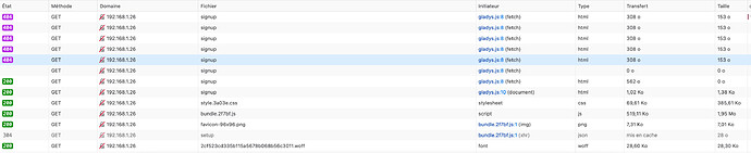

It’s done, I’ve built a new docker image for the setup container, no need to build a new raspberry image :slight_smile:
The js I added (thanks stackoverflow :D)
setInterval(detectGladysContainer, 30000);
var currentHostname = window.location.hostname;
var gladysUrl = 'http://' + currentHostname + '/signup';
function detectGladysContainer() {
    var myRequest = new Request(gladysUrl);
    fetch(myRequest).then(function (response) {
        if (response.status == '200') {
            window.location.replace(gladysUrl);
detectGladysContainer();
It works perfectly :ok_hand:
