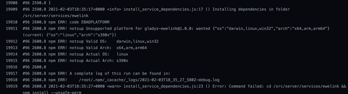

Well, I canceled the build, the service dependencies were not installed because the architecture used for the build on the GitHub action does not match with the compatible architectures of the services:
Apparently, s390x is an IBM architecture…
I looked, @VonOx, the error was also in your builds, but it’s a bit silent because the installation of service dependencies is not blocking to install Gladys…
Maybe we should add a flag when building on CI so that it crashes if the dependencies are not installed successfully, that would be great :sweat_smile:

I’m not sure if on Circle we stopped the Flow if there was an error in the services.
Is this really a dependency issue or just that the platform is not present in the package.json?
No no we didn’t, it was more of a general remark!
No, just the platform not present in package.json, nothing serious
Besides, since it’s not Docker that returns the error but npm via qemu/docker, I think it’s impossible to catch.
We would need to catch it with the service installation script and pass the info to the parent process. I don’t know how. :thinking:
Actually, this installation process is custom, it’s a script that I coded
We just need to make the script crash (currently it’s a silent fail)
In a quick fix, I removed linux/s390x from the build, I don’t think it’s worth investing time to build on IBM architecture :slight_smile:
If someone really needs it, we’ll do more thorough testing and add it, but for now there are some great fixes that need to go to production!
