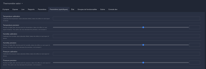

Depending on the model you can perform a calibration directly in Zigbee2MQTT
Below is an example with an Aqara temperature sensor
I had found that, but it’s to get the correct value to correct.
The value is for you to find; each sensor is different, I think, and then you add/remove an offset to the temperature reading of your sensor.

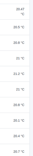

To determine the correct value, I would say you have two options: either you have another device that you consider reliable and use it as a reference, or you calculate the average of all your sensors and use that average as the reference.
So I’ll do the averaging method because there’s no sensor more reliable than that at home — let’s say that out of 10 sensors that should be pretty good
