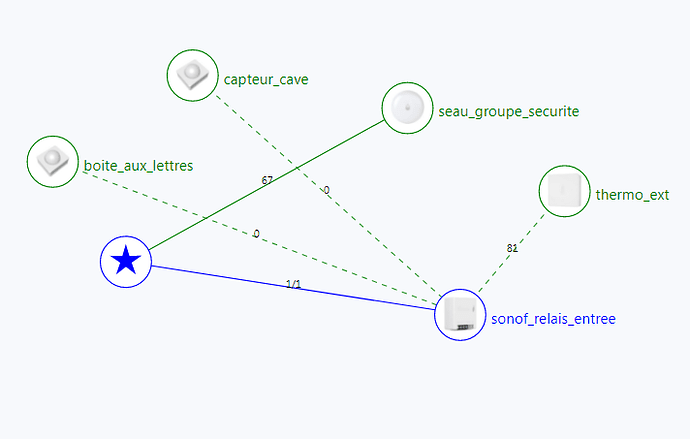

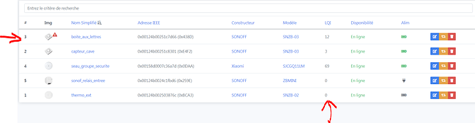

my installation has been working for some time now, I would need explanations regarding the Z2M interface that I have trouble understanding. Already from a quality of reception or db point of view, the famous LQI, in the dashboard I have certain values, and in the diagram I have others? Another point, I removed the battery for 2 days from one of the sensors and Z2M still says connected, I’m losing my Latin or is the interface bugged?
see screenshot
It’s not us who develop zigbee2mqtt (it’s an independent project from gladys)
The LQI changes constantly, and the map is not real-time, it is generated on demand.
The term « connected » is not appropriate, it should rather be translated as « part of the network » & « paired »
Your values are extremely low, in my opinion it’s not the right technology for your use case.

my values are low even though my sensors are only a few meters away, for example the humidity sensor, 2m at most, the others 3 or 4 not even that, well I have a concrete wall separating the Ziegbee key from my sensors but still, I even replaced the antenna with one with more gain
