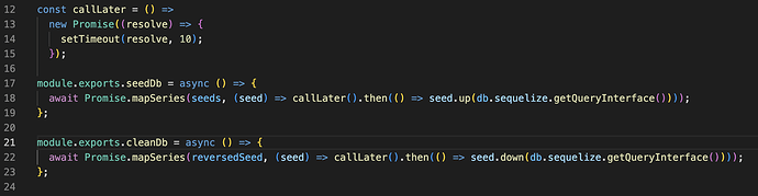

Diving into the code of these two functions « cleanDb » and « seedDb », I come across this:
I’m quite surprised that there’s a function « callLater » that literally adds a 10ms sleep between each clean/fill of each seed :thinking:
Considering we empty/fill 16 tables during the tests, there is 16 * 10 ms * 2 = 320 ms of idle time, between each test!! :melting_face:
Over 1800 tests, that’s 1800 * 320 = 576 seconds = 9.6 minutes!
At that point, I start sweating bullets, all that time wasted… ^^
I try replacing that bit of code with this:
A more optimized version, without waiting.
