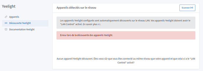

I tried again tonight to be sure and with your last image I confirm that I can no longer find my banner
And nothing in the logs.
Really strange because it was being recognized fine before.

Okay, I managed to find my LED strip.
To detect it I had to turn it on. It had, however, been detected by my router.
I was able to control my LED strip from Gladys and get feedback when I controlled it directly from the Yeelight app. Good news.
However I had the errors below. My strip had crashed; I had to unplug it and plug it back in.

I have no doubt that it works, but given the number of users fighting to test it, I figure it must be highly anticipated (3 years)… :troll:
Moreover, the library used (still at v1.1.0) hasn’t evolved for more than 2 years and the Xiaomi firmwares (previously compatible with Yeelight) no longer allow control over the local network; needless to say, it’s better to migrate to a more long-term solution…
