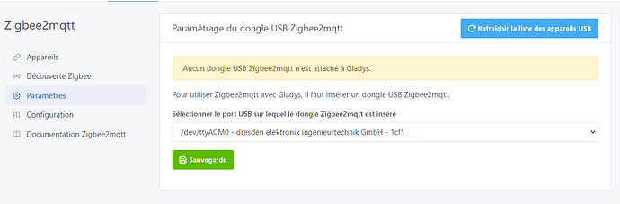

To get back to my problem, yes indeed, I just selected the port and clicked save, but Gladys doesn’t seem to want to validate further, the message remains on no USB port selected.

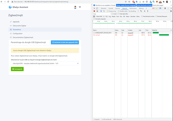

Ok, so indeed we’re not even at the Zigbee2mqtt step.
Are you definitely on Chrome / Firefox or Safari just to be sure?
You can quickly check the requests made by your browser when you display the page and click on save?
(Right-click on the page => Inspect element => Network), then you check if an error occurs during the save.
Can you send us a screenshot of the responses here?
Edit: You’re lucky you get the right to a double live debug with hardware/system with @VonOx and software with me :smiley:
With pleasure.
I confirm that I am Chrome.
It seems there is a 500 error.

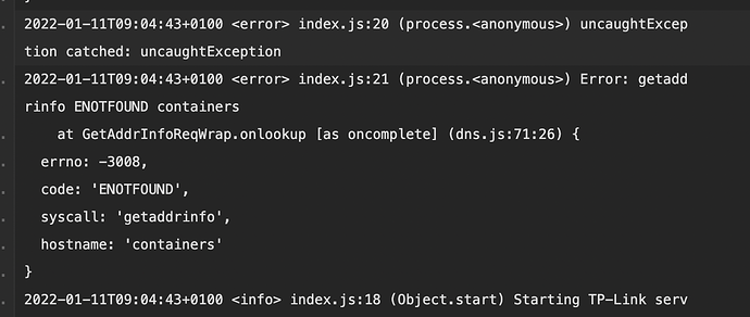

Can you check Gladys’s logs when the 500 error occurs?
docker logs gladys --tail=1000
I wouldn’t be surprised if it’s the issue related to bullseye, the 500 like this on the connect looks a lot like a dockerode error…
Yep, the same as on raspy, except that we go a bit further, the environment is detected

Bingo, that’s right, it’s Debian 11!
Same symptom as on raspberry, dockerode is broken :slight_smile:
