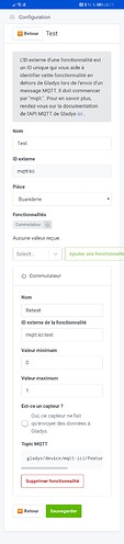

I have a simple question:

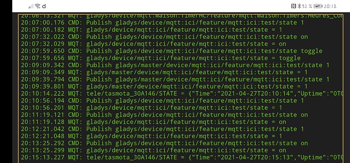

When I add an MQTT switch, I can’t activate (or deactivate) it like a normal switch from a post on the dedicated MQTT topic.
However, if I activate (or deactivate) it via the dashboard, the command appears correctly in MQTT.
I have tried posting « ON » and « 1 ». Should I try something else?
What am I doing wrong?
I know, that’s two questions… :wink:
If I reactivate the option « this device only sends data », it works but then I can’t control my switch from the dashboard.

In fact, I realize that it’s not very clear…
I’m playing with Tasmota. The latter is able to detect a single, double… pentuple press on a button.
I want that when I press the button one/two… times, a scene is executed.
So far, so good.
I created a fake « switch » device in mqtt. If I ask my Tasmota device to publish a « 1 » (or « 0 ») on the dedicated topic when there is a single/double press, the scene is executed because the device state changes.
Where it gets stuck is if I don’t activate the box « this device only sends information to Gladys » (with the aim of being able to activate the switch from Gladys’s Dashboard and execute the scene without having to push the physical button), I can’t act on it! No activation/deactivation/toggle (I do take into account the fact that the topic changes when you deactivate the box « this device only sends… »).
I was wondering if I was doing something wrong or if it wasn’t possible (I doubt it since a switch can send its state and you can act on it via the dashboard).

  • Set your device to « this device only sends information to Gladys ». Copy and paste the topic that is displayed and use it in your tasmota
  • Uncheck the box so that your device is declared as an actuator, which should display another MQTT topic, but don’t take it into account.
  • That’s it, it should work :slight_smile: As the device is declared as an actuator, you should be able to control it from the UI. The topic you retrieved in step 1 should still work

It works then! (I post on the given topic when you check « send only » but I keep this box unchecked)
