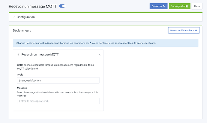

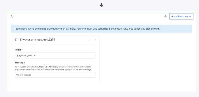

You can absolutely communicate with custom MQTT topics in Gladys without using Node-RED!
We have scene actions that allow receiving MQTT messages / and sending them.
Example of a trigger:
Example of an action:

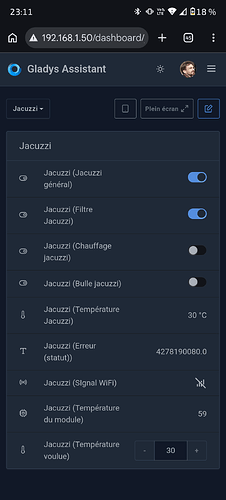

I tinkered with a module to connect my Intex spa as well, and instead of playing with custom topics (which listen to maps but don’t control), I directly modified the program, which must be the same as yours, to send and listen to Gladys topics as well as Gladys values (1 and 0 instead of on and off).
If you’re interested, I can share the modified firmware (and even the setup, although it’s on GitHub).
Here’s the result:

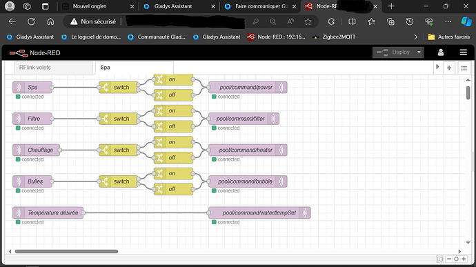

Hello, I solved my problem by going through Node Red to transform Gladys’ 1s and 0s into on and off for my spa. I bought the card from Patitan who manufactures and sells his cards via the Home Assistant forum. The firmware is his and he told me it was coded in Visual Studio Code. I have no idea what that is and how to modify it. I see that you pick up the Wi-Fi signal, that’s interesting.

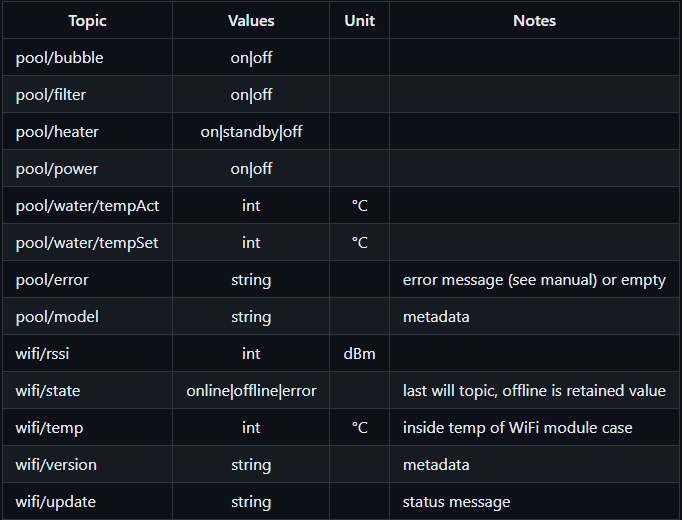

I’ve seen this PaTiTan thing pop up a lot in my research, but I’m not sure what hardware he put in his box. I thought you had gone straight to the source, the guy who did the original coding (GitHub - jnsbyr/esp8266-intexsbh20: MQTT WiFi remote control for the Intex PureSpa SB-H20 and SJB-HS whirlpools · GitHub), because the topics you showed in the screenshot earlier match that development.

The topic to listen to is wifi/rssi, exactly like that as a custom topic in your virtual MQTT device
