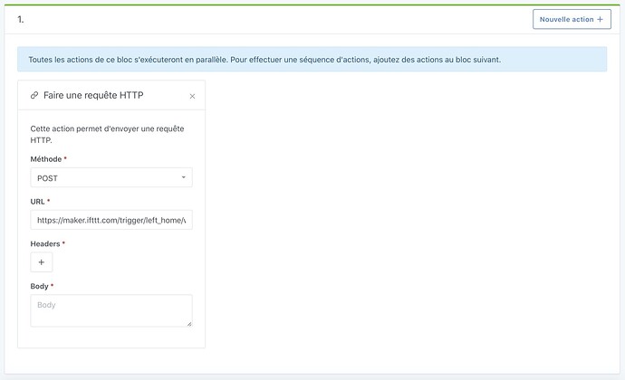

Since Gladys v4.0.3, you can make an HTTP request in scenes (see doc → Faire des requêtes HTTP dans une scène | Gladys Assistant)
You can therefore use this action to call the API of your automatic watering system.
If you want to have a device in Gladys to manually control your device, you can create a « virtual » device in the MQTT integration, and then in the scenes, when the device goes to 1, send an HTTP request to turn on the watering, and when it goes to 0, send an HTTP request to turn off the watering.
