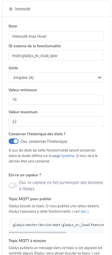

I am looking for a way to enter setpoints in A (amps) on the dashboard similar to temperature setpoints, but when creating « device » widgets I don’t see the virtual devices with intensity values that I created for this purpose. Only on/off devices are accessible.

Did you make sure to uncheck « this feature is a sensor »?

Yes, the option has indeed been unchecked.
It’s an « Intensity » feature in an MQTT device.

Feature creation works well; they are accessible in scenes but not in the dashboard and the « control a device » widget to enter a value. However, boolean features are accessible on the dashboard.

The « Ampere » feature was, until now, only a sensor feature for devices that report amperage values. You’re the first to request control of it, so indeed we haven’t added the ability to do so.
