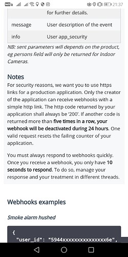

However, when we retrieve the home data via the Netatmo service that @damalgos develops, we find many data including normally the stream
Netatmo security doc:
Netatmo Connect | Security API Documentation
I don’t know if this is related as I read it quickly. (SSL?)

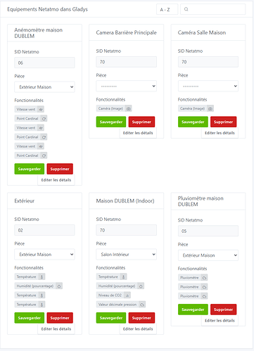

So for the camera part, it’s good, I can create the camera and retrieve its information, notably the video stream :slight_smile:
That’s good news,
If you want, I can test, I have a Netatmo camera.
Yes I agree with @Terdious. As soon as he validates that everything is good I will do a clean-up and test the service :slight_smile:
Because on my side I don’t have a camera ahah so I code with the API and what he can give me :slight_smile:
If you ever want to test:
You can try the netatmo service :slight_smile: And let me know your feedback if you want.
However, I’m not familiar with the camera :slight_smile:
This looks good!!^^
I’ll give you an overview of everything you can recover from the two types of cameras shown above!
