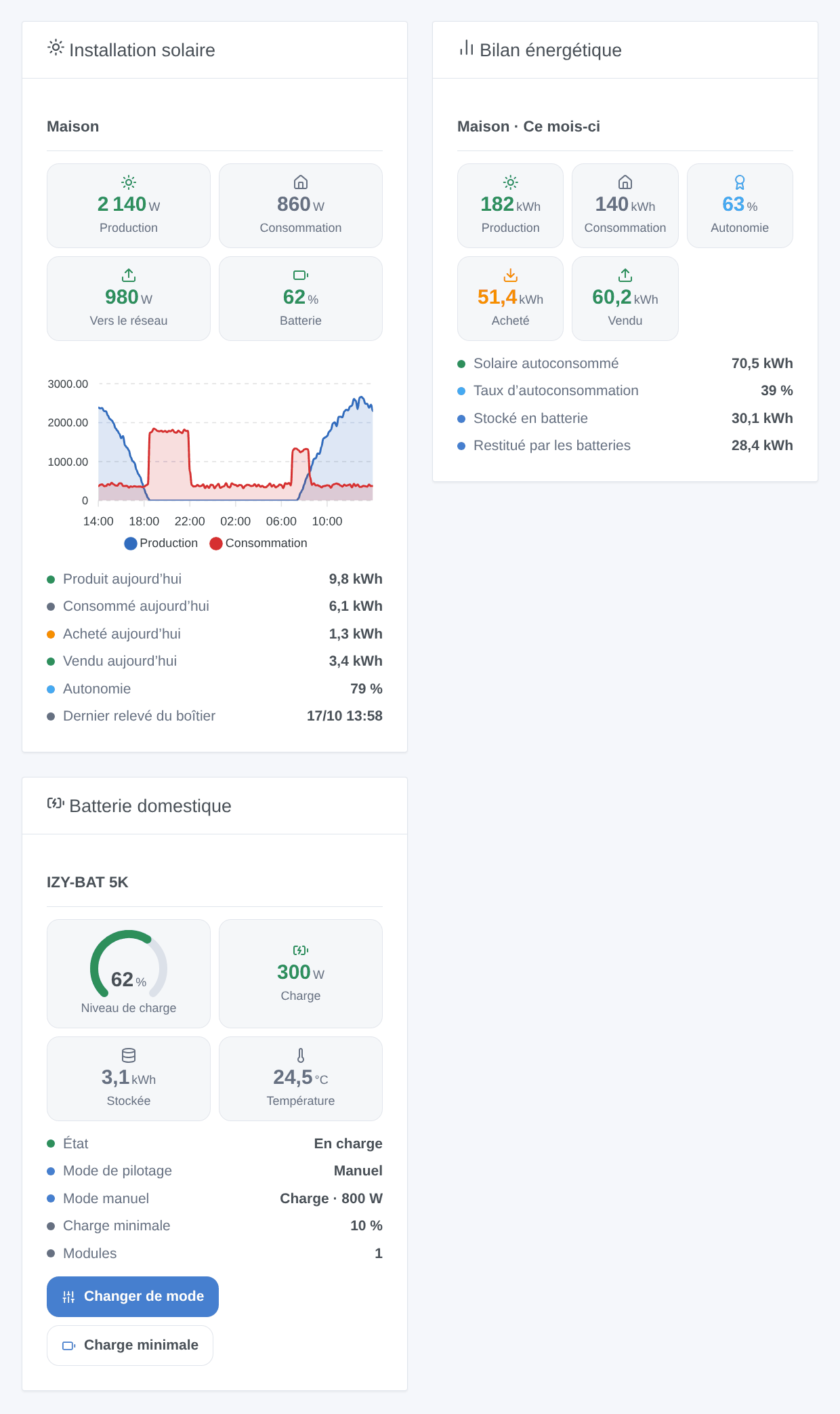

  • One device per battery: level, stored energy, power, temperature, emergency outlet, and the control mode (intelligent, manual, schedule) and manual mode (standby, charge, discharge) in dropdown lists.
  • 3 widgets: « Solar Installation Â» (power + curves of the last 24 hours), « Energy Balance Â» (day, month, year, since installation), « Home Battery Â» (with buttons to change mode and set minimum charge).

Screenshots
The three widgets (generated illustration, not a screenshot)
Generated illustration from the integration code, not a screenshot.
Real screenshots coming soon
I don’t have an Isypower account: real screenshots (configuration, discovery, devices) will be added as soon as a user tests it.
