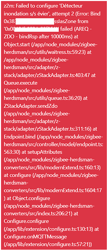

I don’t understand the meaning of the info shown on a red background.

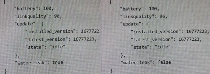

And in Zigbee2mqtt, is the information up to date or not? I imagine not.

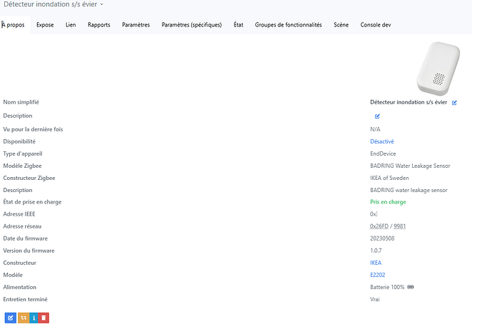

I have these elements:

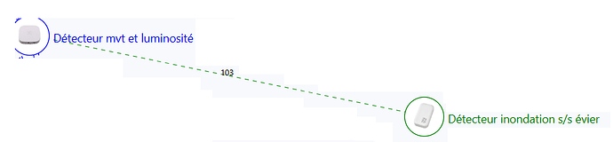

The connection seems to be established normally :

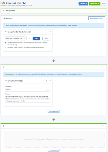

What does your scene look like?
On the dashboard, do you see the status change?
It’s a very simple scene:

I do receive the message when I trigger the startup from the scene.

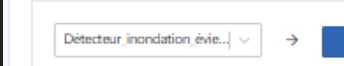

Are you using the right device?
Because in your scene you use the device Détecteur_inondation_evier
But higher up the name of your device is Détecteur inondation s/s évier
Yes, it’s the right device. Well spotted @_Will_71 — I had in the meantime renamed it to remove the spaces and the /.
I’ve also just recreated a new scene after deleting the previous one.
