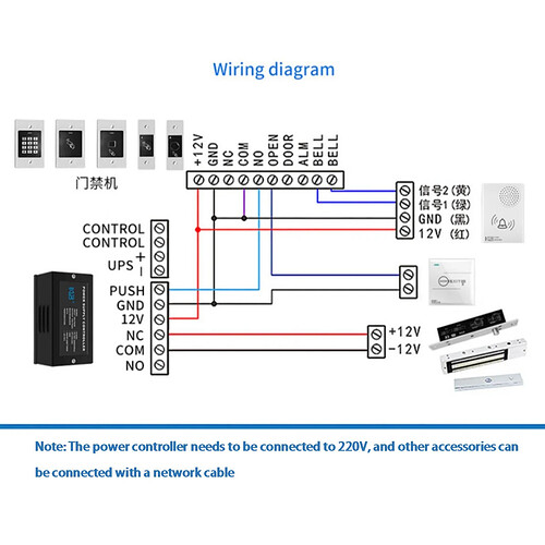

I’m looking to electrify my gate via an electric strike and this type of keypad (code, NFC, biometric)
Since this keypad is not networked, I understand that it can be used with a power controller that handles momentary NO/NC outputs if you want to connect an open button.
A priori I understand that we could connect it directly to the strike via the NC output (without having to buy that controller and using a 12V DC power supply)
Did I understand the wiring diagram correctly?
So this keypad and this controller are not connected, and I couldn’t find this type of controller in Zigbee but only in WiFi
So how can I get the input information (doorbell press and keypad unlock) and receive the output information (open button press) all in Zigbee?
I was thinking of a Zigbee relay to command the strike opening but how do I connect it with the keypad? And how to get the input information?
