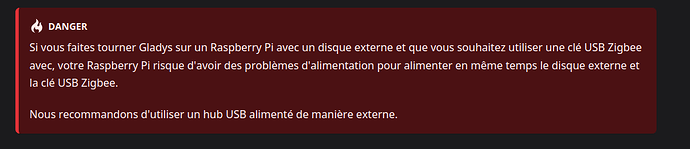

Yes, that’s what you should do, when you connect an external drive you need to power it through a hub.
In the docs @pierre-gilles added an informational note on this topic
