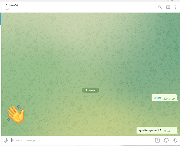

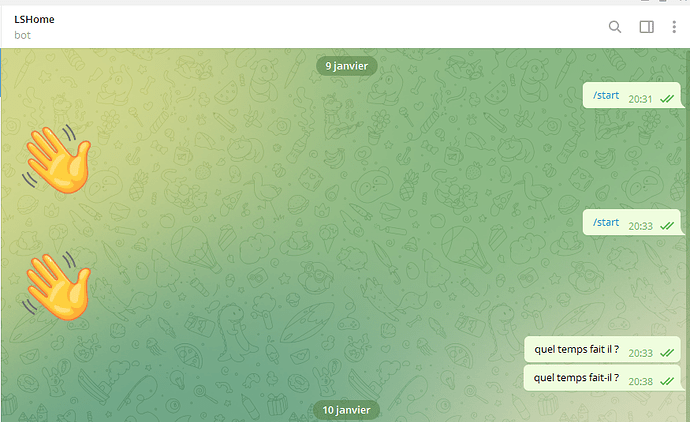

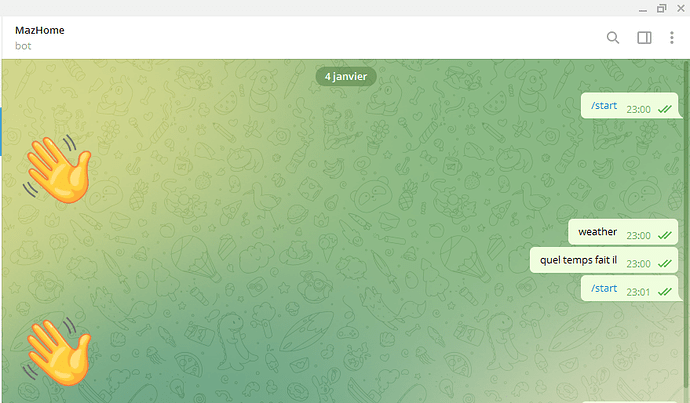

Very strange because if you have the hand emoji :waving_hand:, it means the linking was successful!
Do you have a screenshot of your conversation with the bot?
Here are screenshots of the 2 handshakes created by the bots.
I will try a third bot and keep you informed.
Thanks
Lionel
