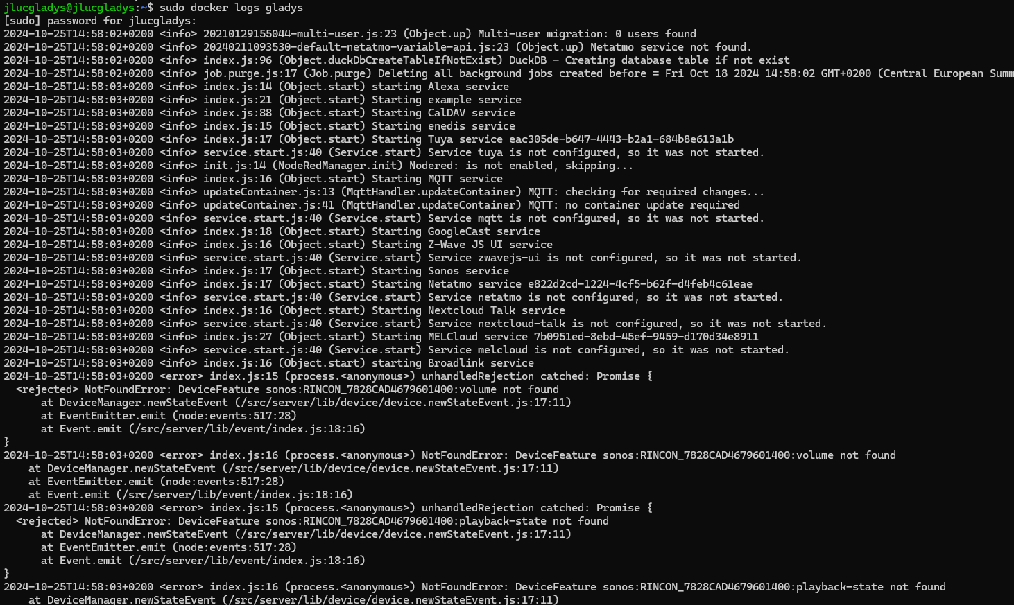

I ran a docker restart gladys and I successfully recovered my configuration.
I ran a docker inspect gladys and everything looks correct :

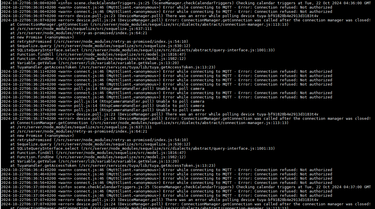

And regarding the logs, I have a recurring Error while connecting to MQTT - Error: Connection refused: Not authorized
Thanks in advance for any help :slightly_smiling_face:

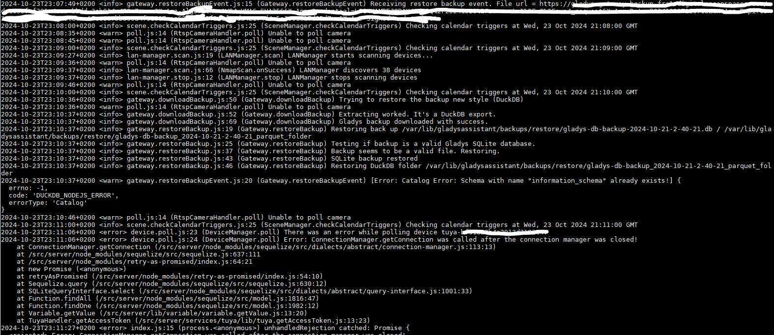

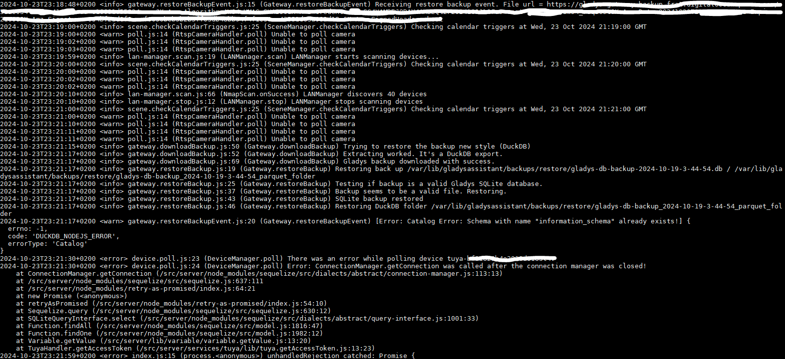

I did some restoration tests of the database from 21/10, 19/10 and the one just before these tests, here are the logs :

In view of the logs, there seems to be a problem during the restoration of the migrated database. Is it possible to perform a manual restoration of the lost data? :thinking:
Thanks a lot for your feedback, I investigated and it’s a bug in DuckDB, I found a GitHub issue that talks about this problem and apparently it was fixed in DuckDB version 1.1:
The fix:
I’m working on Gladys tomorrow, I’ll look into updating DuckDB and it will go out in the next release!
With this fix you should be able to restore without problems.

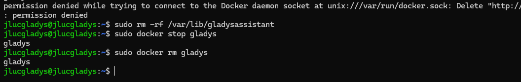

First of all, a big thank you to you, @pierre-gilles, for the quick handling of the issue we’re having with @Tolkyen and also for all the advice that helped me make progress installing Gladys on my new miniPC.

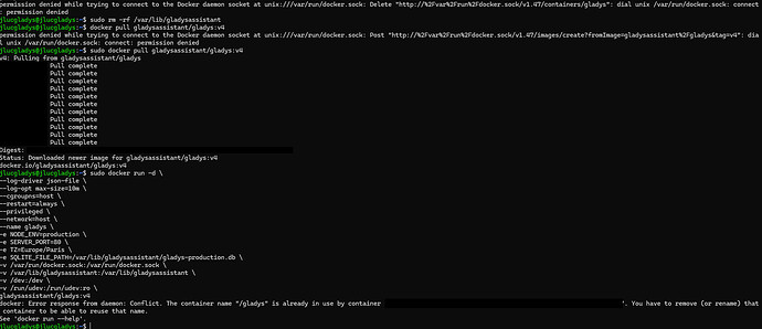

I may have forgotten something or made a wrong move, but these lines appear after running the command:
sudo docker run -d

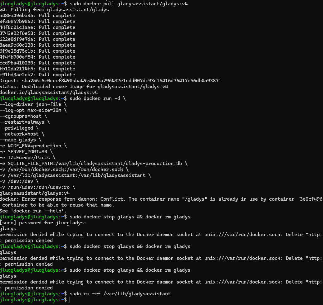

Yes, you didn’t properly run the first command (docker stop / rm), we can see the error; you need to put a “sudo” before the command

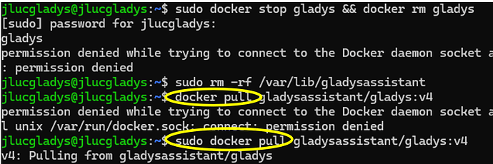

I re-ran it with sudo
And now here’s what is displayed:
Break down the two commands:
sudo docker stop gladys
sudo docker rm gladys
That should work
When I run the commands step by step, it gives:
It seems like nothing is happening
Yes, that’s perfect, it worked

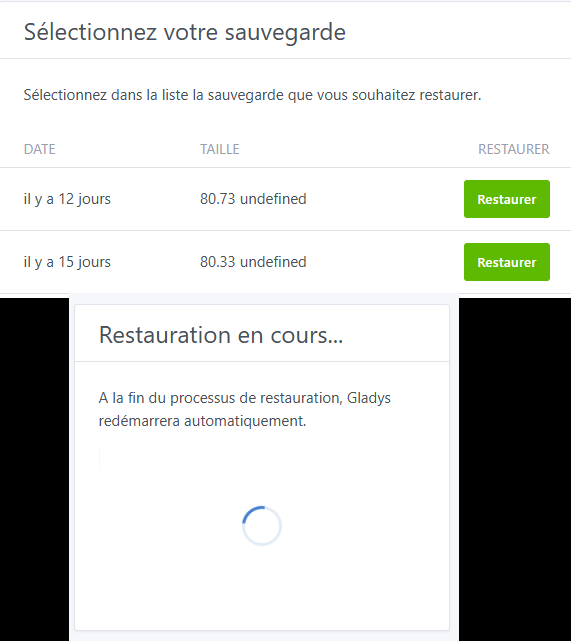

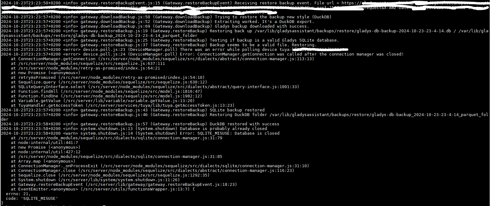

Restore started and has been running for 10 minutes — how long should I expect?
Normally it’s quite fast! It depends on the speed of your internet connection

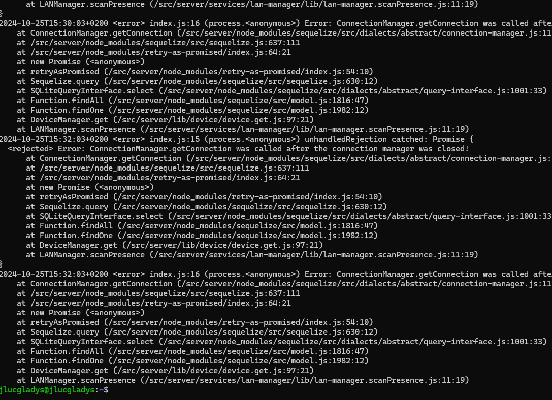

You can monitor the restoration with:
docker logs gladys
I don’t think it’s going to progress any further
The logs you’re showing are perfectly normal, I don’t see the issue :slight_smile:
Look at the end of the logs instead, not the beginning
