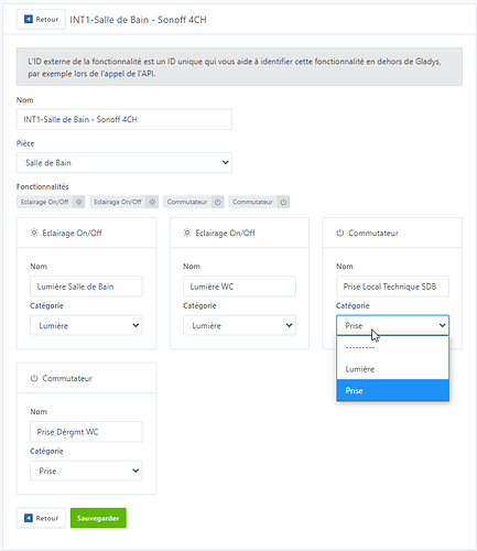

Tests of your PR carried out as follows with a Sonoff 4CH:
  • Modification of 2 of the switch features to lighting: :white_check_mark:
Sonoff 4CH before modification:
Sonoff 4CH after modification:

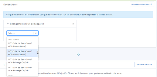

  • Creation of various scenes:
  1. Trigger: 1st switch on ON / Action 1: Control a device: 2nd Switch on ON / Action 2: Control a device: 1st Light on ON - Ok :white_check_mark:
  2. Trigger: 1st light on OFF / Action 1: Control a device: 1st Switch on OFF / Action 2: Control a device: 2nd Light on OFF - Ok :white_check_mark:
  3. Trigger: 1st switch on ON / Action: Turn on the light: Sonoff 4CH - Result: 1st light on so ok :white_check_mark: but 2nd light not on :sos: (Assumption: When a device contains 2 categories Light/Binary, there is no for each provided. The first feature is therefore only taken into account.)
  4. Trigger: 1st light on ON / Action: Turn on the outlet: Sonoff 4CH - Result: 1st switch on so ok :white_check_mark: but 2nd switch not on :sos: (Assumption: When a device contains 2 categories Switch/Binary, there is no for each provided. The first feature is therefore only taken into account.)

Can you put a screenshot of how the part where you modify the type of features looks? :slight_smile:
Arf, it must be noted nowhere because I had completely forgotten:sweat_smile: Sorry!

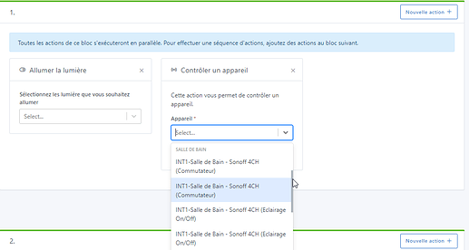

Ah, the « turn on the light » box was designed thinking that devices of type « lamp » necessarily had only one feature. If this box turned on all the lights of the selected device, would that work for you? :slight_smile:
That’s right, the box was created taking into account that a lamp had only one binary feature. If I turn on all the binaries of the device, would that be okay? If it’s okay, you need to create a GitHub issue, otherwise it will be lost in 1 minute :stuck_out_tongue:

Well in this case I really give my point of view on this point, but it will surely have to be validated by others, every time I go through this box, what I expect from it (same for the Turn On/Off the Outlet(s) action of course):
  • That it displays all my devices containing at least one lighting.
  • That I can choose a device that has only one lighting
  • If the device contains multiple lighting features:
    • That I can select the entire device (for example named by the device name with at the end « (All lighting) » : « Sonoff 4CH (All lighting) » and that it controls all the lighting features of this device
    • That I can select a lighting feature of the device: « Sonoff 4CH - Bathroom Lighting » or « Sonoff 4CH - Toilet Lighting » and that it only controls this feature.
All possible scenarios then become « possible » :slight_smile:
