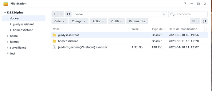

Thanks alex, however both exist — I created them with File Station, the app on my Synology. I can send you a screenshot if you want.

In my opinion there is no need for ‹ /DS220plus › just put ‹ /docker/gladysassistant ›

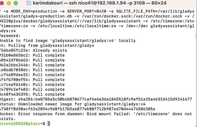

It’s progressing :wink: now I have this error here
@VonOx the same problem I had back then.
The tutorial is probably not up to date
And how did you solve the problem?
Thank you very much, that was the problem.
