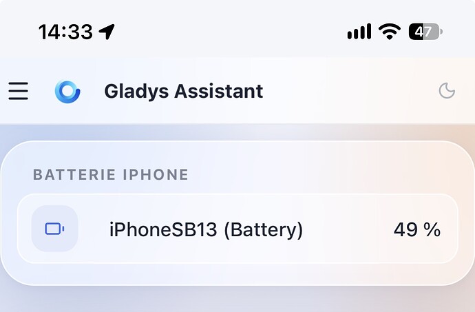

Did you notice there’s an external integration called ‹ Apple device tracer â€ş, and it allows you to see the device’s battery level? It works with my iPhone, so it should work with your iPads.
Here’s a screenshot from my iPhone: the actual battery in the top right corner, and the battery reported in the Gladys dashboard. There’s a 2% difference because the information isn’t real-time, but it’s acceptable for managing charging…

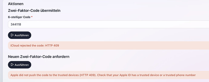

I have now tried the integration, but I can’t get it to work…
I have several trusted devices. I also receive the 2FA code, and when I enter it, I consistently get a 409 error. Are there any known issues here?
Can you post a message on the dedicated thread for a faster resolution?
Hi @stefanbauer
Could you please post a message on the dedicated thread and copy-paste the external integration logs so we can find the issue more quickly :smiling_face:
Thanks
