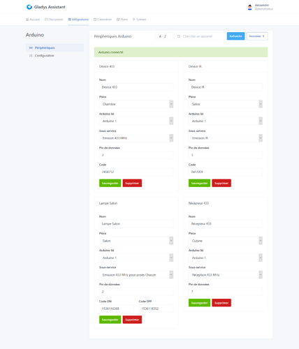

In terms of the interface, here is the current rendering:

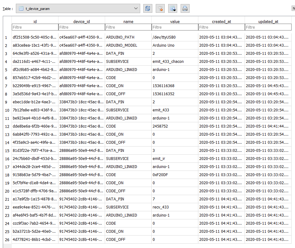

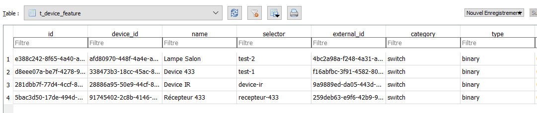

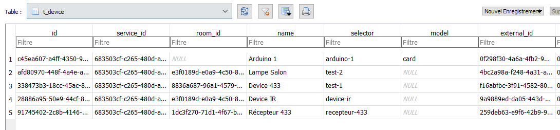

In terms of the DB, we then have:
I added the consideration of IR and 433 MHz codes, which are now stored in the DB, knowing that for Chacon outlets, I took the trouble to take into account 2 ON/OFF codes.
I am still improving the UI, but for me we are touching the end, so I started working a bit on the back, to create communications with the Arduino :wink:

I am looking to create « push » buttons for the dashboard, a bit in the style of Gladys 3:
I started shaping my JSX:
Here is the result:
I can’t find the right reference to change the right switch into a kind of push button. Everything works, the devices react as they should, but it bothers me a bit from an aesthetic point of view… Do you have any ideas to suggest?

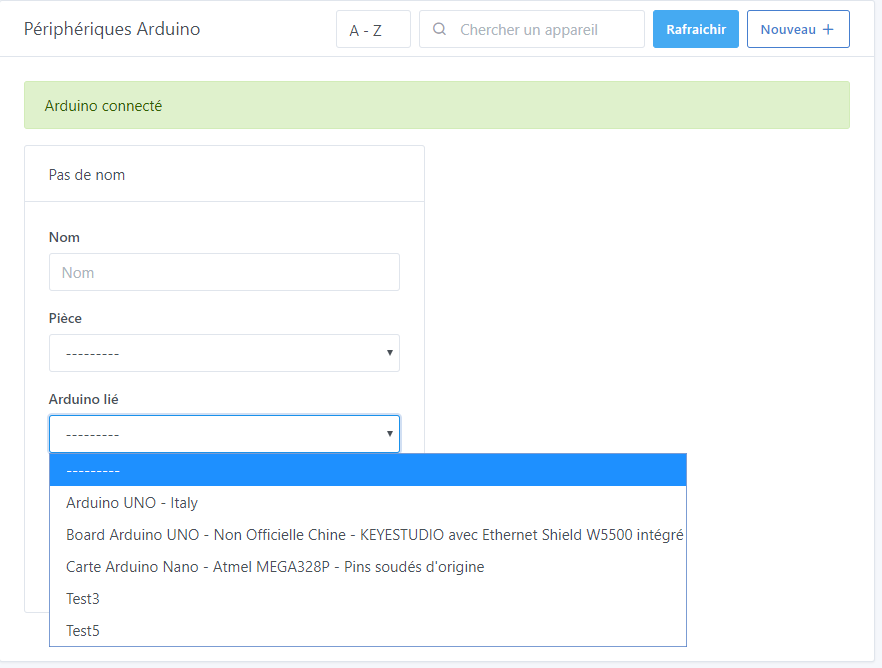

1 issue encountered on the front end but not reproducible afterwards:
When creating the 1st Board, if the page is not refreshed, when you create a new one, the card appears to the right of the 1st card, with a line above it.
Note: I tested creating 5 cards so far, it’s functional
