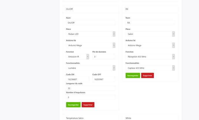

Concretely, here’s what the interface looks like for now:
Devices in the devices page:
My dashboard:

Regarding the dashboard, for « RX », it would be good to let the user choose to put it either in the « MOTION_SENSOR » category or in the « OPENING_SENSOR » category, which will display a custom display showing only the relative time since the last movement/last door opening.
If you’re interested in seeing how this box works, it’s here →
https://github.com/GladysAssistant/Gladys/blob/master/front/src/components/boxs/device-in-room/device-features/SensorDeviceFeature.jsx#L52

Yes, that seems more interesting as an idea, I’ll work on it! But I won’t hide from you that the way I presented it on the dashboard was mainly to be able to make the device say « I’m here! Look, I’ve captured a value » :stuck_out_tongue:

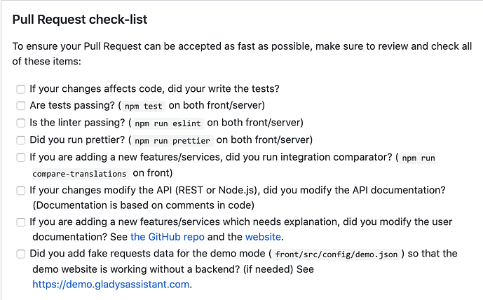

At the top of your PR, you should have noticed there is a checklist of things to verify before submitting your PR for review:
Each point must be checked and validated. I’ll let you look at them one by one :slight_smile:
The most important ones:
The tests
You should have written tests for your integration, I don’t think that’s the case for you? You can take inspiration from the tests of other services (Gladys/server/test/services at master · GladysAssistant/Gladys · GitHub)
To run the tests, you can do npm test in the server folder. If you only want to run a single test, you can set the test to it.only (cf the mocha documentation: Mocha | Classic, reliable, trusted. ☕)
The goal of the tests is to ensure that absolutely everything you have coded is covered by tests and that, in the future, we can be sure that regressions are not introduced by another PR.

No, I haven’t written any tests yet, I’ll take care of that.
Regarding prettier, I modified VS Code to take into account the desired requirements, I’ll recheck file by file.
