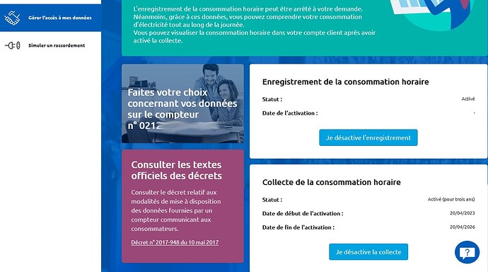

I just checked my online account and hourly data collection had been disabled since January (automatic after 3 years). After reactivating it, I can see the graphs online as well.
Thanks @gaetanb76 for the info.

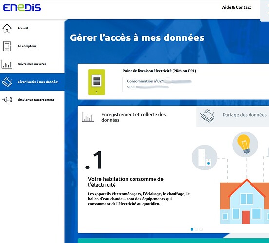

How did you reactivate hourly data collection?
When I go to « Manage access to my data Â», I only have this:
I have this :
and a little further down, this :
You do have a Linky smart meter, right?
Linky meter: yes

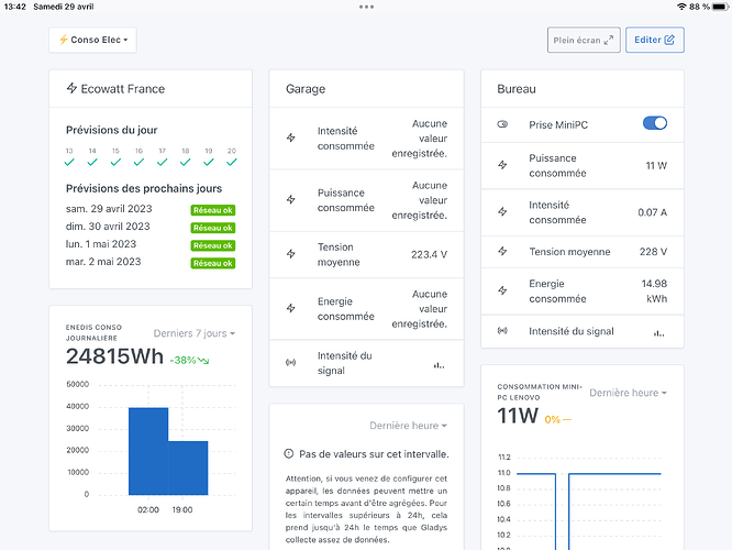

One more note about the interface :
With a tablet, when you want to view the data for the columns on the left in the histogram, the tooltip appears truncated because its left side goes off the screen. (not verified on PC)
Do you have a screenshot? :slight_smile:
Yes, here it is:

For this bug, it comes from the library we use to display the charts. The bug only seems to occur with histograms. I can’t find any fixes, even after updating the library
 :confused: We’ll have to open an issue on the lib, but they seem pretty swamped on their repository.
I’ve created an issue so we don’t lose the bug, but I can’t guarantee anything in the short/medium term — it’s really out of my control: On Chart, when hovering a "Bar" chart, the tooltip can be outside of the window · Issue #1762 · GladysAssistant/Gladys · GitHub
