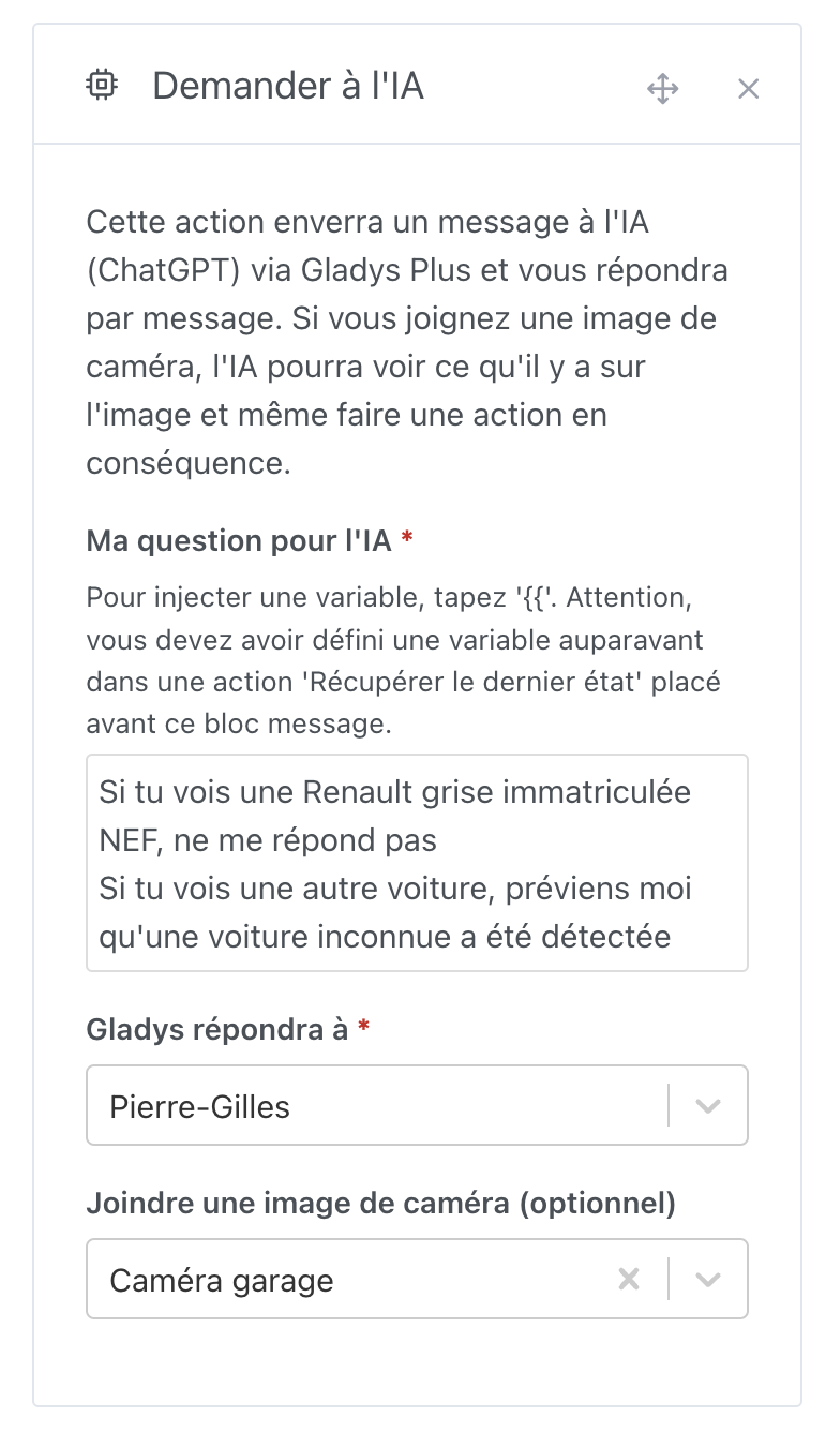

Hi everyone!
In the scene action « Ask the AI », it is now possible to not have any responses!!
For example, you can ask the AI to analyze a camera image, and only notify you if there’s an issue:
You can also ask the AI to analyze sensor values:
In short, anything is possible!!
You now have an AI available in your home that can silently monitor your place until it detects a problem :wink:
I’m curious to know what you’ll do with this feature — feel free to tell me what you’ve set up!

I’m using a scene with the AI,
at the end of this action we see
does this mean that the AI uses this camera only to make its comment, or does it also send an image from the camera in question along with the comment?
Thanks for the answer :wink:
Hi @Psoy !
Good question, it means the AI uses that camera only to make its comment.
If you want to receive the image by message, you need to add a « Send a camera image » block :slight_smile:

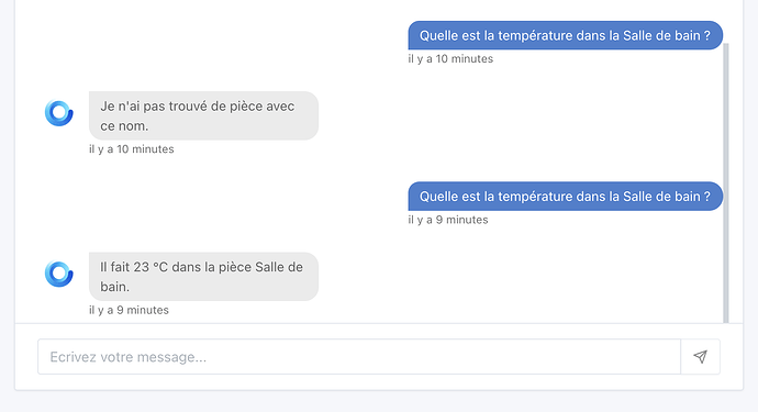

Hi @pierre-gilles,
I’m bumping this thread but I hadn’t really looked into AI until now..
I see all the prompts you make and they look great but when I try simple prompts they don’t work:
Hi, none of the prompts you tested are part of the features available right now :smiley:
The list of available features is here:
Edit : For the bathroom temperature, that should work. Are you sure of the room name and that you have a temperature sensor in that room?

OK I see, thanks.
For the bathroom, yes I have a sensor:
I managed, but it’s not practical:
Maybe a silly question, but… do you have Gladys Plus?
I just tested it, and indeed you have to insist. Actually, it’s not a prompt issue, but rather that ChatGPT hallucinates.
One minute apart, with the exact same prompt:
![Screenshot 2025-10-09 at 11.12.33|690x375](upload://b
