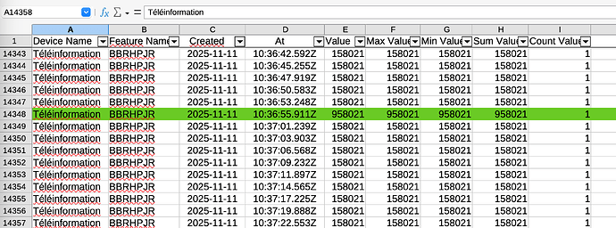

Following up on my post here about an erroneous value in one of my Tempo indexes (probably due to a data sending error from my teleinfo2mqtt system).
I just retrieved the values from 11/11/25 (with Yaak) to check what happened and there is an erroneous value that has been recorded (800 kWh too much) :frowning:
Is there a way to change/delete this value?
Is there no before/after value verification when calculating the energy monitoring so as to ignore/remove an erroneous value?
Of course, you would need to define what constitutes an erroneous value for Gladys…
And for the 30-minute consumption calculations, is it done on the sum of each value of each row, or as an average, or on each value every 30 minutes, etc.?
I also made a request to have a cleanup of unnecessary values for the indexes
